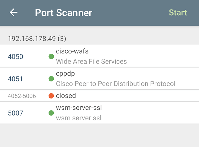

    Port scan shows it’s up and running. Also the logs show no error.

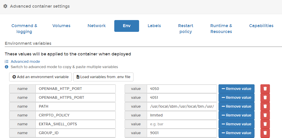

I changed this in the Docker container environment settings:
Did you also set the LSP port in docker (not in the picture…)?

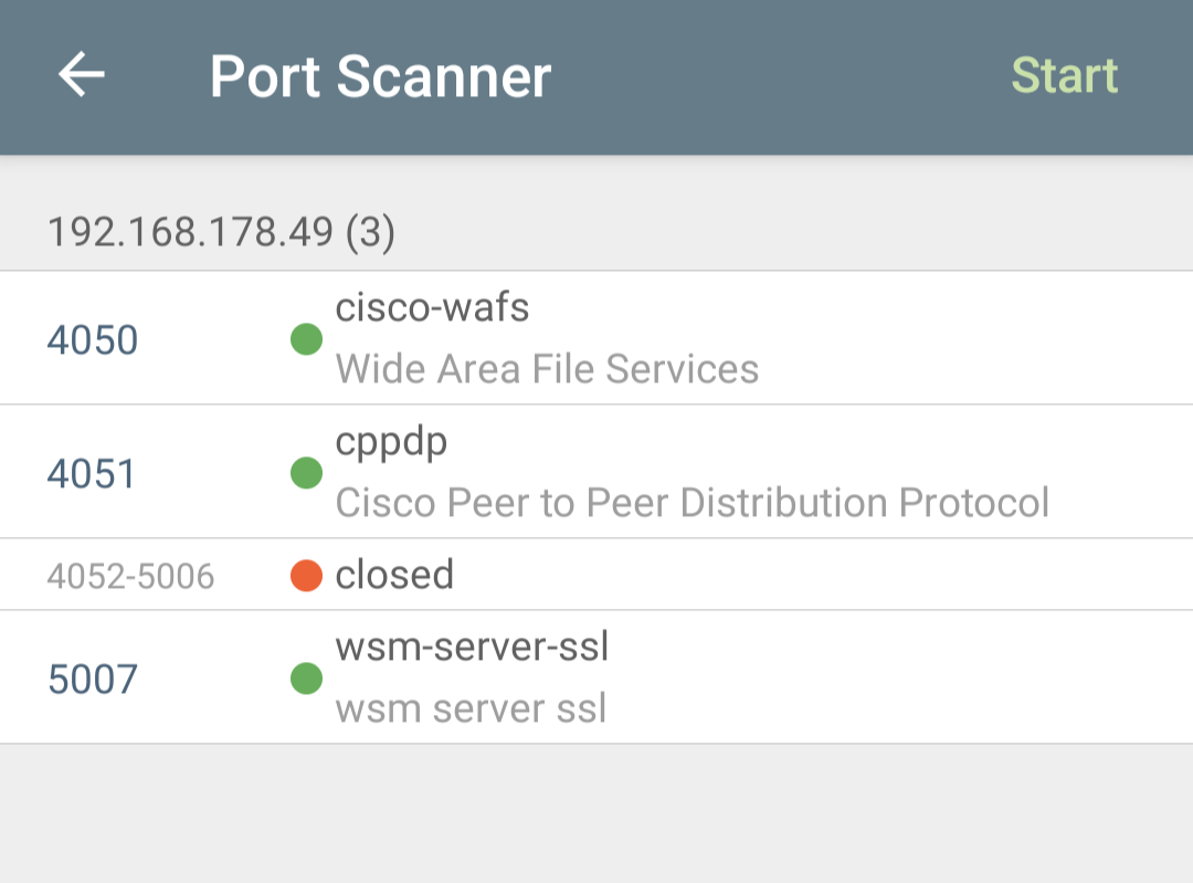

The LSP port is reachable at port 5007. I checked it by Port scanner.
