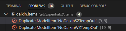

If there are errors like these…

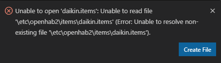

…I can’t click on the error message itself to open the place where it occured, because I get this message then:
The reason is clear to me: The error message points to the path on the SD card on the raspberry, but when VSCode tries to open /etc/…, it doesn’t lead somewhere useful for my windows machine.
My question is: Is there e.g. some configuration setting in VSCode to resolve this difference in the paths?
Thanks,
Boby
Are you connected to the pi using samba or SSH?
