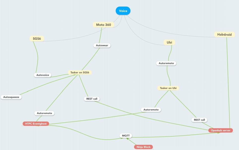

I have been considering my voice command structure for a while, as I use voice with my android devices (phone and Moto 360), an Ubi voice controlled computer, and now with Openhab. I have been considering a way to centralise my voice actions, and suspect this will be best performed using Google + Autovoice, tasker and then distribution over MQTT, REST calls and using AutoRemote.
Eventually, I want to be able to say something to any of my voice entry points (phone, watch, Ubi, other future devices) and get the same result, without having to remember which system links with which voice entry portal.
This is a WIP mind map showing my current flows, but I will want to adapt over time…
The HTPC Eventghost is for things like Media Center, Kodi, Netflix etc. Openhab does all my environment and lights. Ninja Block is mainly now used to accumulate sensor data from 433 devices and MQTT them to Openhab.
Any thoughts on integration?
