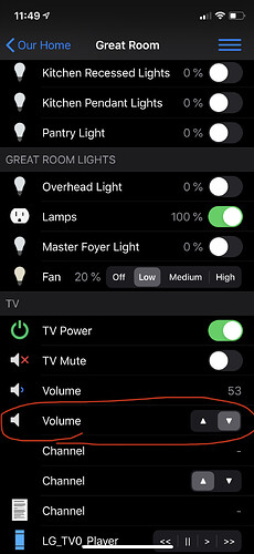

I think I found a bug in the iOS app as i am having an issue controlling the volume on my TV.
I have not changed this part of my configuration for months and it suddenly stopped working a week ago.
I will post my item, rule, sitemap files below for context.
The issue:
When in the iOS app, the volume button only works when the opposite option is selected, and it only works once. See below screenshot. So for example if the down arrow is selected, down wont work but up will. But once you press up, now IT is selected and you can now only hit down. This results in only being able to turn the volume up and down 1 time, back and forth.
In contrast, on my computer, it works as expected, you can turn the volume up and down as much as you like.
If there is some issue with my configuration then please let me know.
