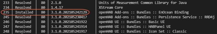

Are you sure that the new jar is loaded correctly? Log in to the karaf console of the OH instance and use bundle:list to check, the version number of the bundle should include a timestamp of when it was built. Also note that it might take a couple of seconds before the jar is loaded after you put it in the addons folder.
Thank you for the hint. Yes, the build date suggests that the JAR is loaded correctly. However, I noticed that this is the only file that has the state “Installed” and not “Resolved”. I don’t know what that means.
So it looks like it is compiling the “wrong” code, using the original code from the repository instead of my own code. I started from scatch several times (by fully deleting the openHAB instance and the git repository), making the changes before the first build, but it still uses the original code judging from the line numbers in the call stack.

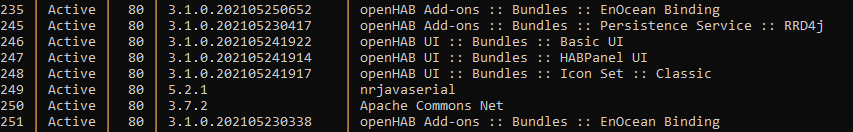

Thanks for the hint. The initial snapshot was taken after I uninstalled the binding in the Web UI (sorry, I forgot). After reinstalling the binding in the Web UI, I have two (active) JAR files:
That was my presumption from the beginning, and your suggestion helped to prove it.
