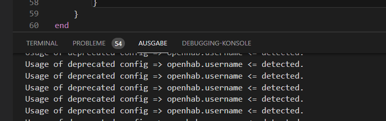

Do you get any errors in the output terminal?
Like this:
Maybe @Confectrician help.
