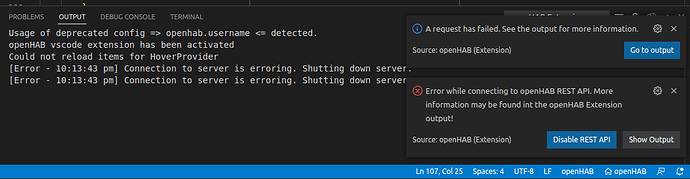

I checked both set-ups, both are the same… however, I get server errors on the machine, like so:
The output screen says this:
Usage of deprecated config => openhab.username <= detected.
openHAB vscode extension has been activated
Could not reload items for HoverProvider
[Error - 10:13:43 pm] Connection to server is erroring. Shutting down server.
    Error:
        Error while connecting to openHAB REST API.
    Message:
        Error: connect ETIMEDOUT 192.158.1.5:8080
The interesting thing is the complaint above about Usage of deprecated config => openhab.username <= detected. which I am obviously not using.

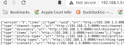

Yes, can connect to 8080 and get my sitemap (from the VScode mache and all others)…

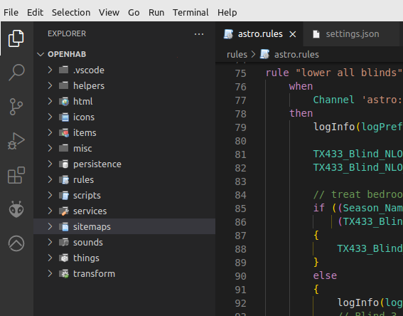

Also see, can open, mod and save files to the openHAB machine (via VScode).

And can browse the REST directory…
