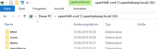

Seems like my network share with folder openHAB-conf is ok.
All my openHAB files appear in VS Code (Latest Version) installed on Win10.

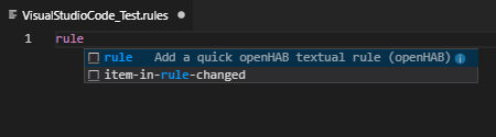

But there is no code completion active. I expected something like shown in openhab-demo.gif.
As @rlkoshak mentions in his post, there should be a code completion with <ctrl><space>.
When I type in rule + <ctrl><space> like shown in openhab-demo.gif, I get a message ‘loading’, but then nothing happens.

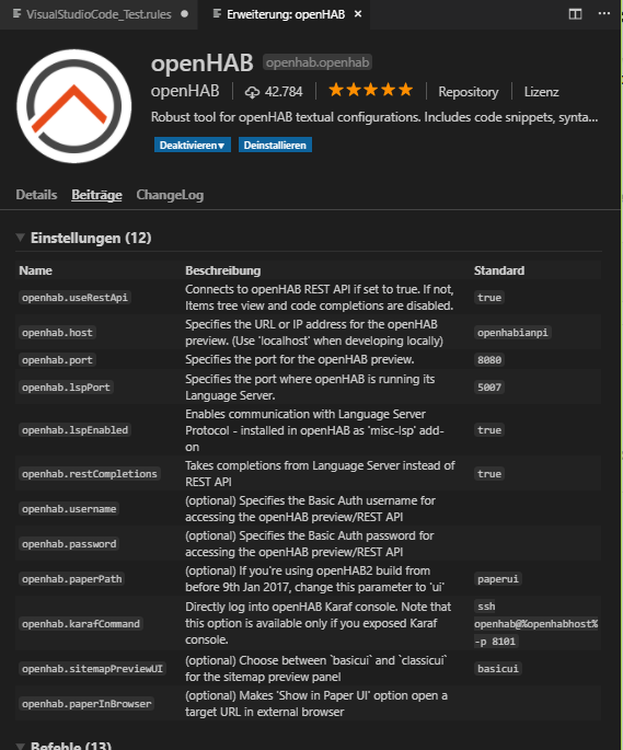

Instruction say:
openhab.host (mandatory), default: openhabianpi
openhab.port (optional), default: 8080
Instruction also say: These settings should work fine on Windows machines and openHAB installations using the recommended openHABian setup.
That’s why I think my settings are correct. Am I wrong?

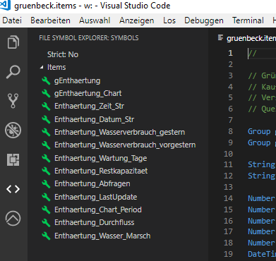

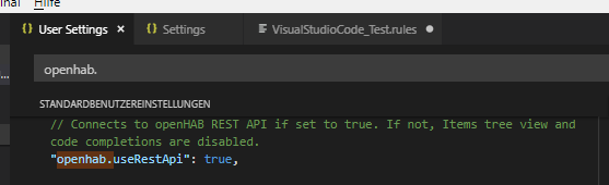

While trying different user settings I switched openhab.useRestApi from default true to false and now code completion and Items treeview are functional !!!
I do not understand that, because of the comment in settings.json file.
It says with setting false Items tree view and code completions are not possible.
Is that a bug? Are the values reversed?

After setting openhab.useRestApi to false code completion works. Items/Things treeview now shows now “There is no data provider registered that can provide view data.” instead of being empty.
De-/activating and re-installing openHAB Extension has no effect.
Windows 7 Home Premium SP1, openHAB 2.4.0 Release Build, VS Code 1.30.1 (user setup), Extension openHAB 0.4.1.
Anyone any idea how to show entries in Items/Things treeview?
Turn on openhab.useRestApi again.
Items and Things are grabbed through restApi so they cannot be shown, when you turn it off in the config.
if you are facing performance problems with code completion, when Rest API is enabled you can try to set openhab.restCompletions to false instead.
