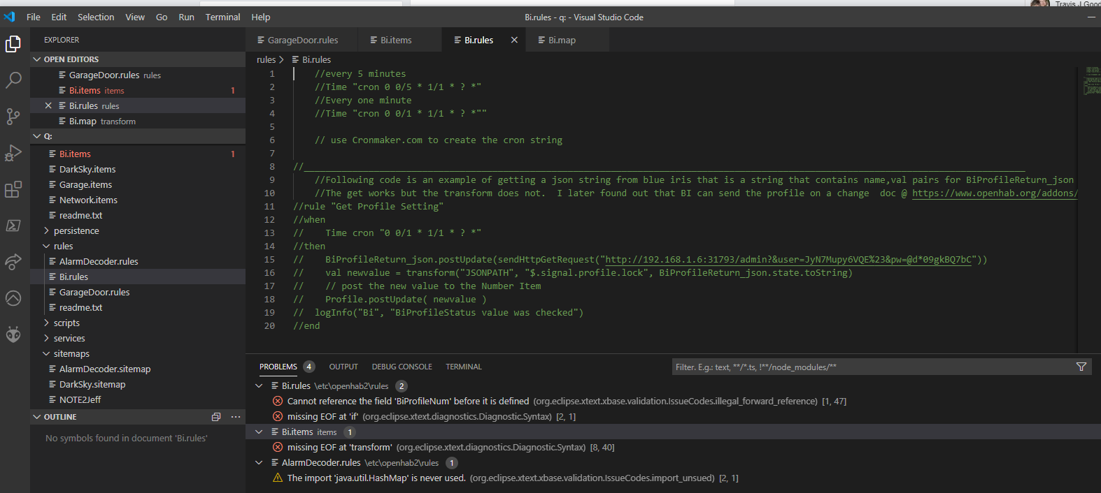

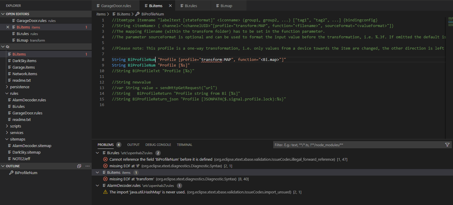

  • Issue of the topic: VSC shows errors for lines in files that have been deleted even after saving ths file. Restarting VSC does eliminate the errors. I’ve noticed that VSC seems to loose state from time to time with PIO and C++ code and there is a clear button that seems to just reset all the error and check again. Is there a similar way to freshen it up for OH?

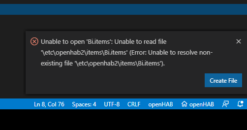

I also get this message when attempting to use the error message to navigate to the coding error
Hey @MickPB
I can only imagine that some caching is going on there.
You are using the remote lsp and we have (state now) no programmatical influence on the behavior.
What our vcscode extension does with remote LSP:
  • Start a connection to your openHAB instance on LSP port
  • That’s it
  • Everything else is in the background (done by standard lsp packages available from Microsoft
What we could try in the future is to reconnect on purpose.
This may help solve the problem since you say that restarting helps out.
About your last picture:
This is a known issue which remains unadressed currently due to the same situation.
The error reponse is send from your remote LSP server with the corresponding paths from your openHAB environment.
That’s the reason vscode doesn’t know those paths and the files.
