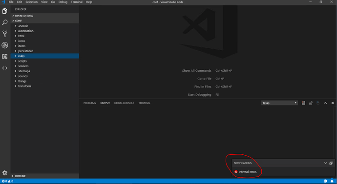

Actually the error is happening on VSC itself, (1.29. 1), once i start it it it shows the below image:
It doesn’t show any other details.

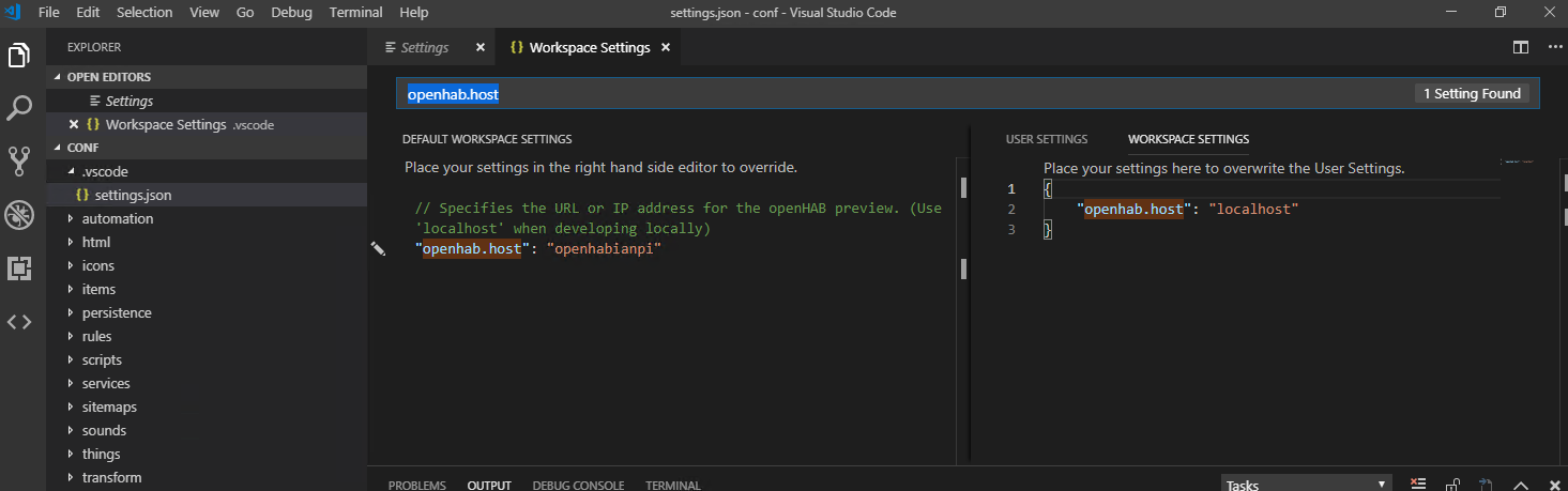

I have the same error on M6 and I’m using openHab on RPi (openHabian with the included samba share if that matters). However this error shows up after starting VSC, but I can use it without problems…

anyway, it wouldn’t hurt to specify all parameters in your json:
    "openhab.username": "",
    "openhab.password": "",
    "openhab.port": 8080,
    "openhab.lspPort": 5007,
    "openhab.host": "localhost",
    "openhab.useRestApi": true,
    "openhab.lspEnabled": true,
    "openhab.restCompletions": true,
    "openhab.paperInBrowser": true

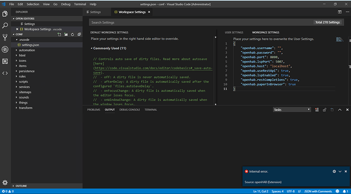

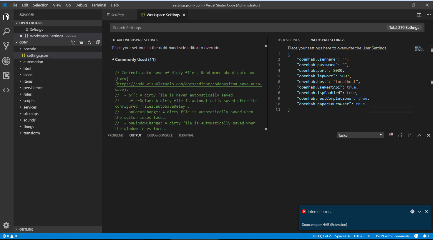

That is the weird part :). it is totally empty, no problems, no debug nothing!!! just the notification that there is internal error and that is all.
I did add all the config as per you recommendation, but same error appears :frowning:
