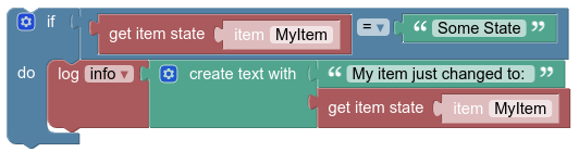

Blocky, however, could be a very valuable resource, if you decide to try javascript. When you make a blocky script, there’s a little blue button image in the bottom right-hand corner. Pushing that will show you the underlying javascript that corresponds to your blocky code and this is a very good way to start to get comfortable with the basics of javascript in OH.
becomes
if (itemRegistry.getItem('MyItem').getState() == 'Some State') {
  logger.info(('My item just changed to: ' + String(itemRegistry.getItem('MyItem').getState())));
Obviously, you can only learn the js that has corresponding blocky blocks at the moment, but that’s a pretty solid foundation.

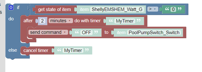

This seems to work for me
