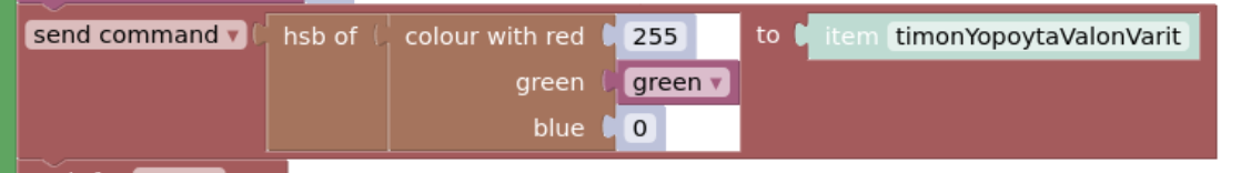

This is my first attempt at using blockly. This does what I want it to do:

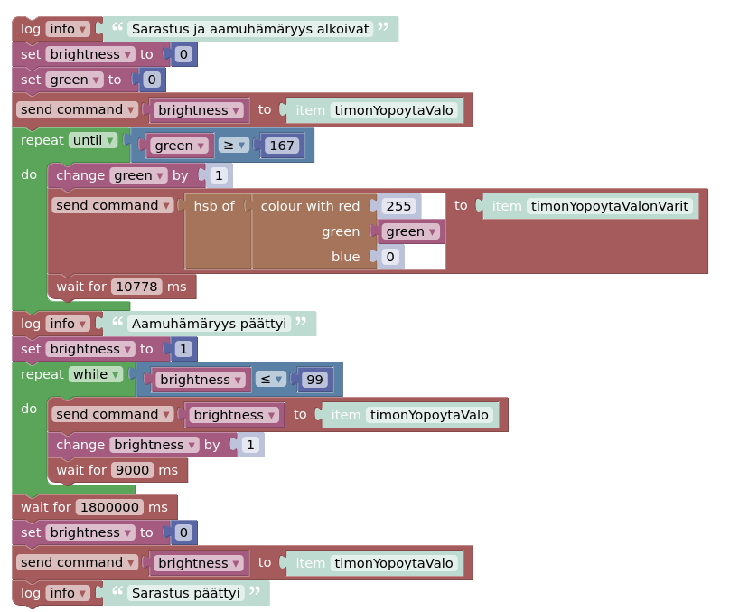

All of those waits give me a little bit of concern. I’m not sure it’s that big of a deal unless there is even a slight chance that this rule could get triggered more than once in the nearly 75 minutes that this rule will currently take to exit you might be facing some problems. For example, if somehow this rule were triggered 20 times in the morning, this rule would be running all day over and over again.
Luckily it’s not that hard to prevent that. You can either add an if statement to only run the above if the light and/or current time ist right (e.g. if the light is already brightness 99 and green >= 167 there’s nothing to do, or if it’s more than an hour past the usual time to run) or, even better, add a condition (i.e. “but only if”) to do these checks and prevent the actions from running if the conditions are not right.

Shortly, the script is supposed to during the first 30 minutes make my bedside lamp run through a sunrise palette of colours and then in 15 minutes run up the warm white light from 1% to 100%. The lamp will stay on for half an hour and then shut it self off. I trigger it with cron from the UI. It has now run once. I will now go the bed and see and report what happens tomorrow morning.

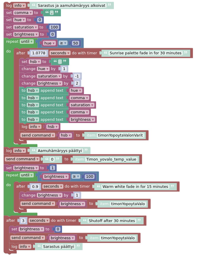

If you are really looking to improve the code, you should look into using timers instead of waits. The big difference is that the timer gets scheduled to run in the future instead of blocking execution of the rule for a given amount of time.
But the code can become a little more complex as a result because now it doesn’t just execute from the top to the bottom.
Yes, that would make sense, will try.
Is there a way to provide H, S and B values directly with Blockly? The starting sequence is too bright, and it woul be great to fade up Brightness along with the sunrise palette.

It almost works, but no cigar. The transformation does not allow for setting the B value, Brightness, individually for HSB.
In RGB the higher the number the higher the brightness. So use lower RGB values and the light will be dimmer. For example, 50% brightness white will be 128,128,128 RGB value.

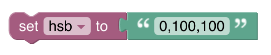

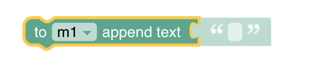

Setting the brightness alone switches the mode of the lamp to White light. I would like to create a hsb string, but how do I do that? There is no concatenation block in blockly?
You need to create a variable.

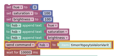

[rnal.defaultscope.ScriptBusEventImpl] - Command 'undefined0100100' cannot be parsed for item 'timonYopoytaValonVarit (Type=ColorItem, State=3.0,100,100, Label=Timon Yöpöytävalon värit, Category=colorlight, Tags=[Lightbulb]
Still no cigar…
Great success!
When I said you need to use a variable, I meant you needed to assign the values to a variable.
Though, given you are hard coding each value anyway
You only need to build up the string if one or more of the values is coming from somewhere else, such as being calculated in a while loop.
As I want to change all three, h, s and b, while the fade in happens this seems to do the trick.
