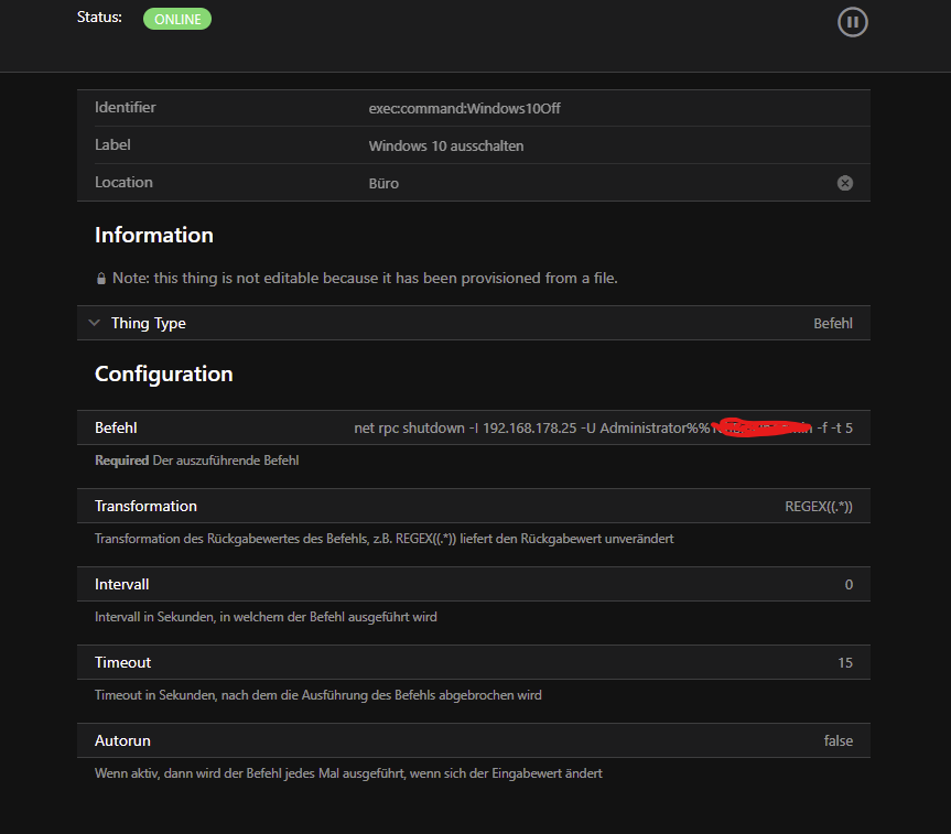

break;
EXEC Binding with RPC shutdown command for the OFF case above:
