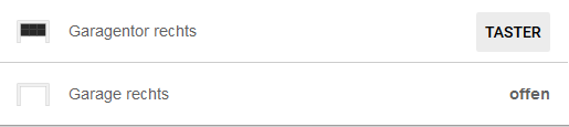

Want a Switch item to display a Contact status
my garage has a button that simply opens, stops or closes my garage door. to check if the door is open or closed I`ve a sensor that closes when the door is closed. In the BasicUI I have two items:
I use a proxy with rules to translate the switch into a contact.
items:
Switch FibUN1_IN1 {channel=“zwave:device:4dfe5541:node15:sensor_binary1”}
Contact GaragentorrechtsProxy “Garage rechts [MAP(garage.map):%s]”
sitemap:
Switch item=Garage_rechts mappings=[ON=“Taster”]
Text item=GaragentorrechtsProxy
Is there a chance that the “Garagentor rechts” switch displays the status of the Sensor “Garage rechts”. I`d like to have only one line in the GUI, instead of two. “Taster” should display the value of the Sensor.
thx

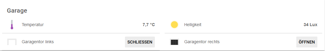

I need to put Switch item Garage_links on my sitemap because this switch (its actually acting as button) rolls up or down the garagedoor. When the garagedoor is closed another Switch item (FibUN1_IN1) changes to CLOSED. now I would like the GUI to display something like this:
grafik
any idea?
Switch item=aGarageOpener1 icon="garagedoorclosed" mappings=[ON=Open]  visibility=[vGarageOpener1 == CLOSED]
                Switch item=aGarageOpener1 icon="garagedooropen"   mappings=[ON=Close] visibility=[vGarageOpener1 == OPEN]
thanks Rich, that works.
the icons garagedoorclosed and open do not properly show. (shown as door half-way open). I did a workaround and created garage_open.svg and garage_closed.svg and put it in the icons directory…
