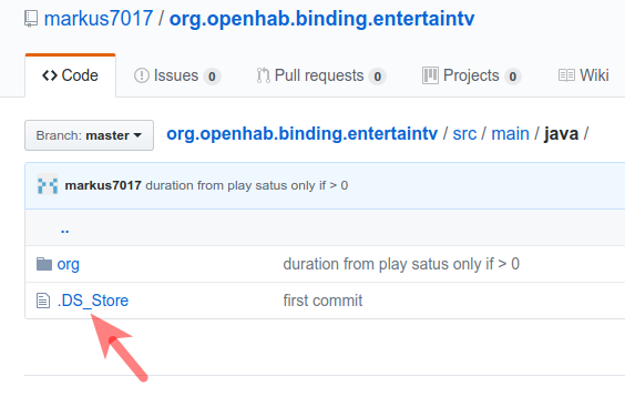

there are no .DS_Store files (including hidden files)
If they are not there… then what is this?
