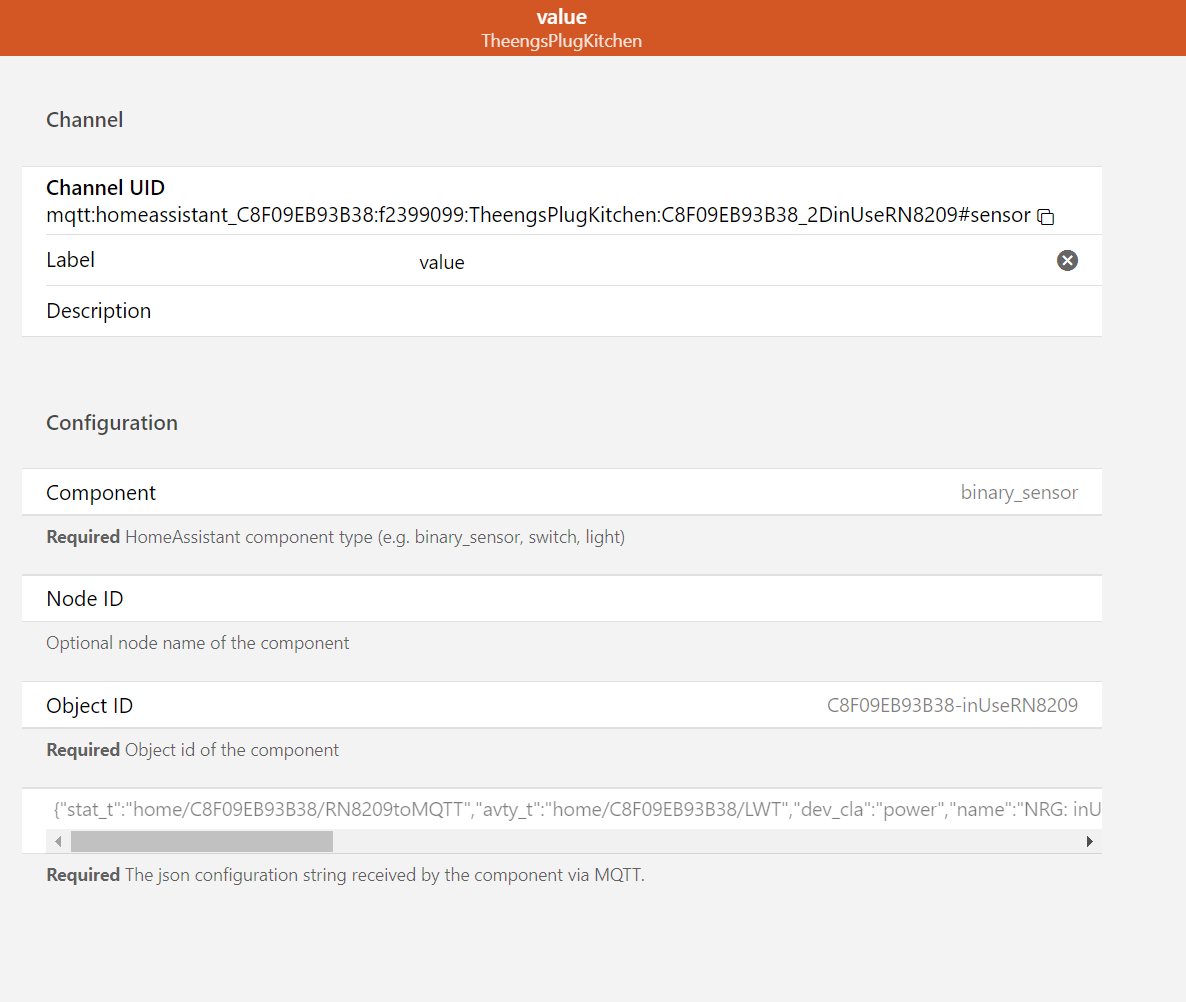

Sorry if I’m being dense, but I can’t find the place you’re defining this transform on the UI. Is it on the Thing, Channel, or the Item? What’s the label on the field? Could you maybe include a screen shot of the whole page?
I can show you how my textual configuration comes up in the UI.
It’s when selecting the Plug Thing > Channels > State channel > Configure Channel > Show advanced
Hope this helps.
None of my channels have the Show Advanced checkbox. Is there some trick to getting that displayed? Here’s the one that is causing the warnings.
Correct, if you use auto-discovery there won’t be any Show Advanced check boxes, but the required definitions will be in the bottom field.
The problem here being that openHAB doesn’t implement the Home Assistant discovery convention fully compatible, and certain types are not supported at all, this specific binary_sensor type inUseRN8209 being one of them. For other types like switches there is also a problem with the assigned name, as you might have also discovered.
You might want to delete this point to avoid the warnings until we may find out how the HA discovery convention has only been partially implemented. Unfortunately incomplete and missing documentation about discovery conventions doesn’t make it a straight forward endeavour at the moment.
I don’t have a point for this so there’s nothing to delete. I’m getting a lot of other noise in the log from this Thing too. I’m thinking of starting over without auto discovery. What do you think? How would I do that? Just set ohdisc on the device to false?
Just set the general disc to false, so that there are no more discovery messages created under the homeassistant topic. At the same time you should also delete the already existing respective discovery entries entries under the homeassistant topic.
Or you could just delete the affected entries after setting disc to false, as openHAB seems to have implemented sensor and number entries correctly, but just cannot deal properly with switch, binary_sensor, device_tracker etc. entries at this stage.
