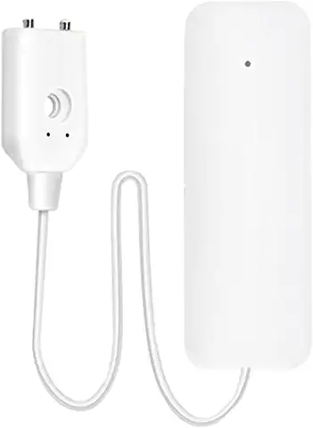

New idea: cut the end of of water-leak sensor, tape the wires to the machine, and put a strip of conductive tape or aluminium foil on the door to close the circuit.
I kind of want to do this now.
