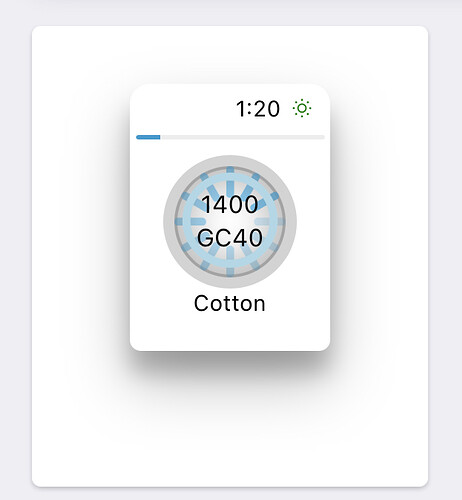

Thanks a lot @DrRSatzteil for this great Widget :slight_smile:
I use it with the Siemens/Bosch HomeConnect Binding.
I did some small modifications today to implement some parameters provided by the HomeConnect Binding for Washer and Dryer.
I replaced the “dummy” buttons with the “RemainingTime” used from the binding.
The following parameters are added to your wonderful :slight_smile: widget as well.
  • Progress (used in a progress)
  • SpinSpeed
  • Temperatur
  • ProgramMode
When the Widget is set in “Dryer” mode, then the colors are changing from blue to red.

                                  - component: Label
                                      text: =Math.floor(items[props.item + '_Remainingprogramtime' ].state.split(' ')[0] /3600) + ':' + (Math.floor(items[props.item +  '_Remainingprogramtime'].state.split(' ')[0] /60)  - Math.floor(items[props.item + '_Remainingprogramtime'].state.split(' ')[0] /3600)  * 60)
                                      visible: "=(items[props.item + '_Remainingprogramtime' ].state === 'UNDEF' || items[props.item + '_Remainingprogramtime' ].state === '0 s') ? false : true"
                                      style:
                                        font-size: 10px
                                  - component: f7-icon
                                      f7: "=(items[props.item + '_OperationState'].state === 'UNDEF' || items[props.item + '_OperationState'].state === 'Ready') ? 'circle_fill' : 'sun_min'"
                                      style:
                                        align-self: center
                                        color: "=(items[props.item + '_OperationState'].state === 'UNDEF' || items[props.item + '_OperationState'].state === 'Ready') ? 'gray' : 'green'"
                            - component: f7-progressbar
                                progress: =Number.parseInt(items[props.item + '_ProgressState'].state)
                                infinite: false
                                style:
                                  --f7-progressbar-progress-color: "=Number.parseInt(items[props.item + '_ProgressState'].state) == 100 ? '#00ff00' : props.isDryer === true ? 'red' : '#179cd1'"
                                  --f7-progressbar-bg-color: "#ededed"
                                  --f7-progressbar-height: 2px
                                  width: 85px
                                  z-index: 999
                            - component: f7-block
                                class:
                                  - display-flex
                                  - justify-content-center
                                  - align-items-center
                                style:
                                  height: 60px
                                  width: 60px
                                  border: 5pt solid lightgray
                                  border-radius: 50%
                                  margin-top: 7px
                                default:
                                  - component: f7-preloader
                                      colorTheme: "=props.isDryer === true ? 'red' : 'lightblue'"
                                      visible: =items[props.item + '_OperationState'].state == 'Run'
                                      style:
                                        position: absolute
                                      f7: "=items[props.item + '_OperationState'].state ==  'Finished' ? 'circle_bottomthird_split' : 'circle'"
                                      style:
                                        color: "=(items[props.item + '_OperationState'].state === 'UNDEF' || items[props.item + '_OperationState'].state === 'Ready') ? 'lightgray' : props.isDryer === true ? '#ff4f4f' : 'lightblue'"
                                        border-radius: 50%
                                        box-shadow: 0 0 16px 8px rgba(0, 0, 0, 0.25) inset
                                  - component: f7-block-header
                                      class:
                                        - no-margin
                                      style:
                                        position: absolute
                                        text-align: center
                                      default:
                                        - component: Label
                                            text: "=items[props.item + '_SpinSpeed'].displayState === NULL ? items[props.item + '_SpinSpeed'].state.split('RPM')[1] : items[props.item + '_SpinSpeed'].displayState.split(' ')[0]"
                                            style:
                                              font-size: 11px
                                              color: black
                                        - component: Label
                                            text: "=items[props.item + '_WashingProgramTemperature'].displayState === NULL ? items[props.item + '_WashingProgramTemperature'].state.split('.')[4] : items[props.item + '_WashingProgramTemperature'].displayState"
                                            style:
                                              font-size: 11px
                                              color: black
                            - component: Label
                                text: "=items[props.item + '_ActiveProgram'].state !== 'UNDEF' ? items[props.item + '_ActiveProgram'].state : ''"
                                style:
                                  font-size: 10px
                                  color: black
