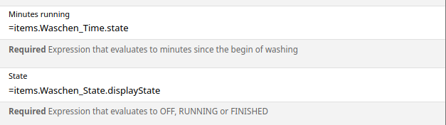

Hi @elektrolubach,
I tried the same with my items:

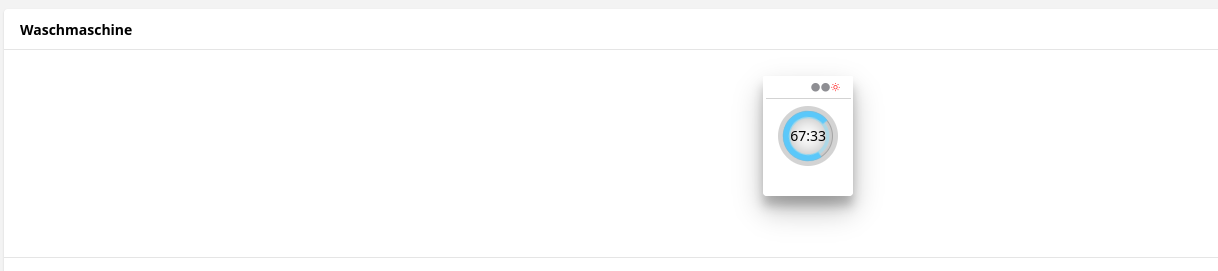

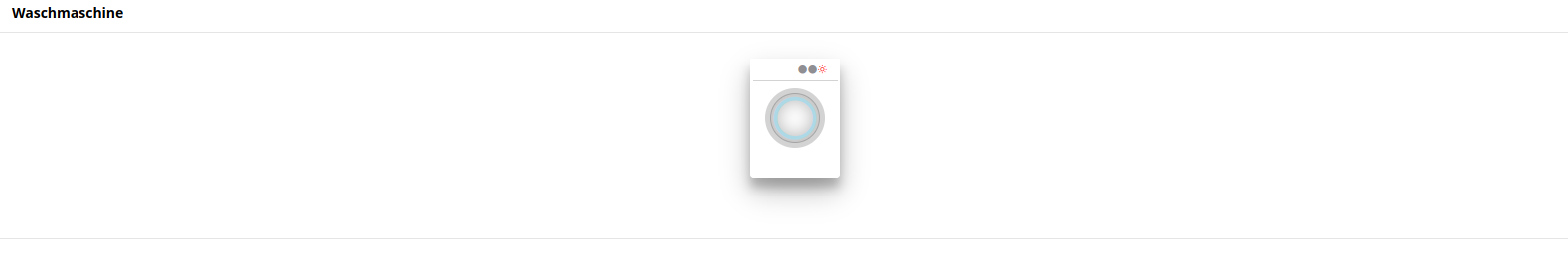

For the item “time” the result is strange: In “edit” mode the time is displayed:
in the “run” mode it is not:
Any idea what could be the reason?

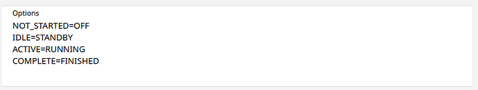

The status item does not work. My mapping under State Description looks like this:
Ideas are welcome…
Unfortunately I think you cannot use the state description since I don’t use the displayState in the widget (could be an improvement).
This should also be the reason why you don’t see the time displayed. It is only shown in RUNNING mode.

However, as you can see in my following post, I tried it with a transformation under “State Description” | Options. Actually, the item should directly return the values that the widget expects? When I look at the item itself, that is the case.
Oh well… my answer was not correct. Try to use .displayState instead of .state for your item.
Oh I see you did this already… hm…
Ah OK.
Understood.
I have my difficulties with YAML but I can try to customize it …
I did this because @elektrolubach has posted a screenshot that corresponds exactly to my scenario…
After playing with it for half an hour now, it works… I do not understand! Browser cache?
