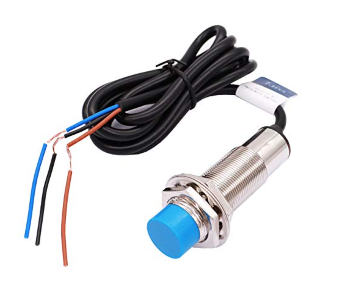

I use this one. Transmits values via mqtt. Works very good.
Watermeter
I connected inductive sensor that bought from aliexpress for couple of euros to the GPIO of my raspberry Pi running the OpenHAB and I use MQTTany - GPIO and more over MQTT to get the data. Also works fine.
Because of the operating voltage of the inductive sensor is higher than what the GPIO can accept, optocoupler in between should be used and also >5V power supply to feed the sensor.

I’m assuming the inductive sensor should be placed near the meter spinning wheel, most likely on top of it, as the top is the only not metallic part of my water meter.
The sensor will send voltage readings related to the wheel rotation speed.
Is that right?
Could you please tell me the brand/model of the sensor?
As I am only concerned with leaks, all I need to know is if the wheel is spinning or not, so maybe I will not need the optocoupler.
Will I?
Thanks again,
Usually the utility water meters have a location where you can put a sensor, but that depends on the meter
No, the wheel on my meter does one rotation per liter so when the sensor detects the metal you wil receive a pulse which you will need to count. That is where MQTTany comes in.
No, the optocoupler is used to separate voltages and you will always need it if you want to connect the sensor to rPi.
Have a look at the following link. I have the same meter and sensor.
