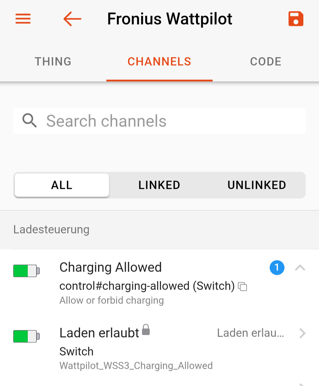

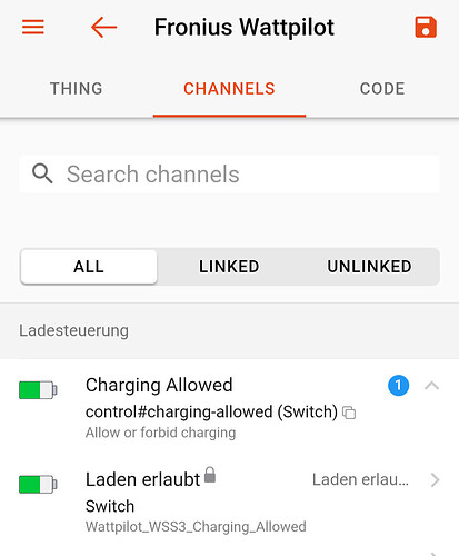

With the charging-allowed channel you can disable charging.
I think that‘s the equivalent of clicking on the circle in the app. It can be used to pause/disable charging, but is not related to authentication.
