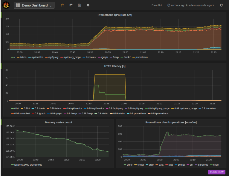

So let’s assume this is an XY Problem. What are you really after? While having a bunch of screens with raw logs scrolling by may look cool, it is frankly not all that useful. This is, I believe, one of the main reasons why you are struggling to find something that works. In real control centers that I’ve seen (i.e. operational ones, not as seen on TV) you never see screens up with scrolling logs. Instead you see stuff like this from Prometheus using Grafana (tutorial and openHAB plugin for integration with openHAB can be found at: New Add-on bundle for Prometheus health Metrics)

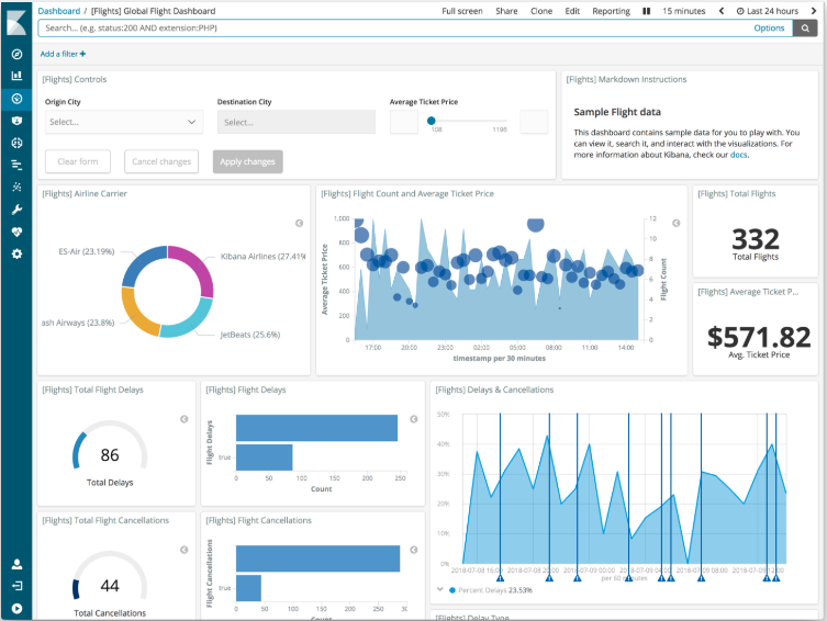

or the following using Kibana which is part of the ELK Stack (tutorial for setting up ELK with openHAB: Logging to Logstash+Elasticsearch+Kibana)
or using one of the many log visualization tools that are out there, both commercial and open source (search Google for “log visualization”). Note that Grafana can be used with other log aggregators besides Prometheus.
In short, what people have are systems that monitor the logs looking for certain patterns and that generate alerts when those patterns are detected. If they look at any sort of visualization at all, it will be a graphical aggregation dashboard like those presented above.
