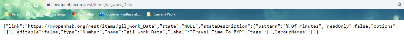

I don’t use HABPanel so I can’t really say why it is showing anything there. But in BasicUI, “-” usually means the Item is NULL or UNDEF. Look in openhab.log to make sure there are no errors. Look in events.log to make sure that the Item is changing state.

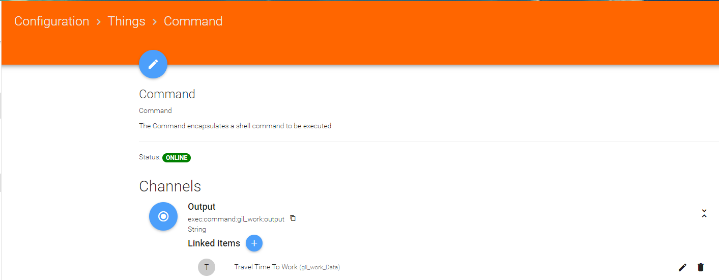

i have an issue
the items do not get updated
meantime, i have implemented the things and items with the sample script as below (scripts works from command line)
String gil_work_Data "Travel Time To BYP [%.0f Minutes]" { channel="exec:command:gil_work:output" }
String  gil_home_Data "Travel Time Home [%.0f Minutes]" { channel="exec:command:gil_home:output" }
Things
Thing exec:command:gil_work [command="python /etc/openhab2/scripts/waze-sample.py", interval=300, timeout=5, transform="REGEX(.*Time (.*) minutes.*)"]*
Thing exec:command:gil_home [command="python /etc/openhab2/scripts/waze-sample.py", interval=300, timeout=5, transform="REGEX(.*Time (.*) minutes.*)"]*

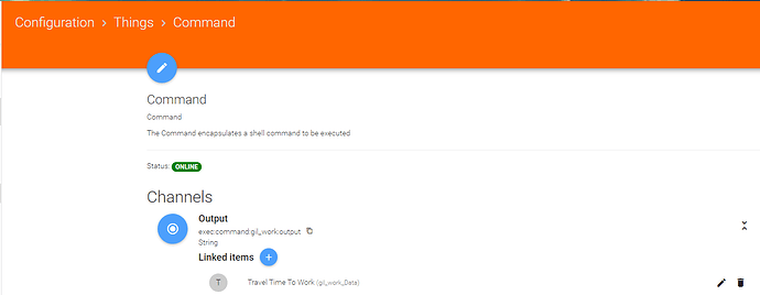

The thing is well displayed with the associated item in paper ui

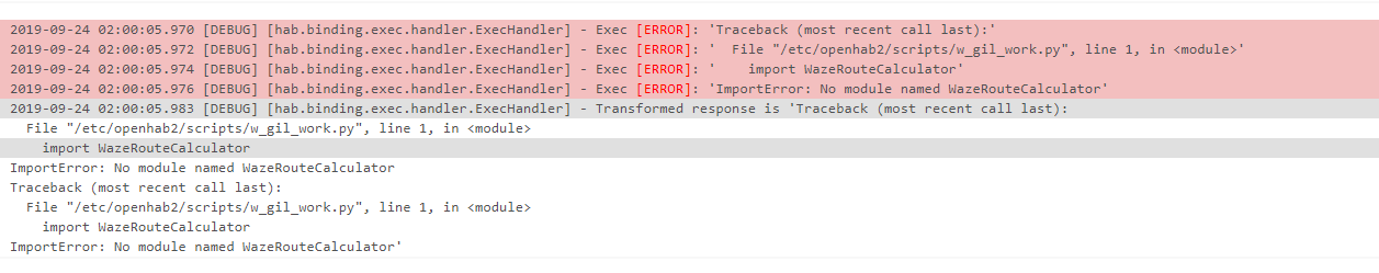

in the log, it looks like that it’s running but no update
i think that the pip worked only for openhabian user and not for the openhab user
i have made a chmod on the scripts folder but here i am blocked

i guess the issue that it was necessary to make the pip under su openhab
