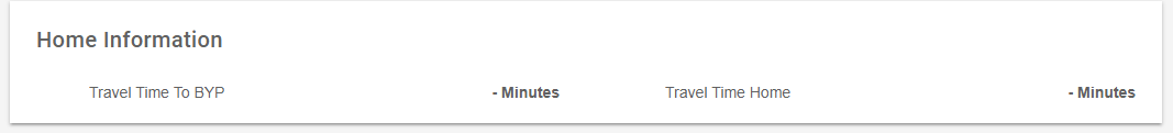

I’m trying to format the number to only the digits before the decimal point on my sitemap and HabPanel but am not having any luck…
I’ve used the typical [%.2f] in the label with no luck - is this because of the REGEX transform?
Thanks,
Squid
It’s because it is a String Item. %.2f will only work with Numbers.
Aha! - So what might be the best way to format the digits?
Either modify the REGEX to not include the decimal point and parts or use a Number Item.
Duh…should have thought it through a bit more!
So I changed the items type to NUMBER and my items look like this..
Number BYPRoute_Data "Travel Time To BYP [%.0f Minutes]" { channel="exec:command:BYPRoute:output" }
Number HomeRoute_Data "Travel Time Home [%.0f Minutes]" { channel="exec:command:HomeRoute:output" }
If I look at the items in HabPanel they display correctly…
Yet I can’t get them to display at all in BasicUI
Am I overlooking something simple??? :thinking:

@KidSquid - you have Number Items there. Does this work for you? You’re using Windows? I am on RPi and Number Items do not work. String - OK. Numbers - all null.
I’m having an issue with BasicUI, but the data displays in HabPanel. If you look up a couple of posts you’ll see I mentioned this and was wondering why it worked in one and not in the other.
Originally it was a String item, but I wanted more formatting flexibility so Rick suggested that o switch it to a Number item. I’m hoping someone can offer some insight.
