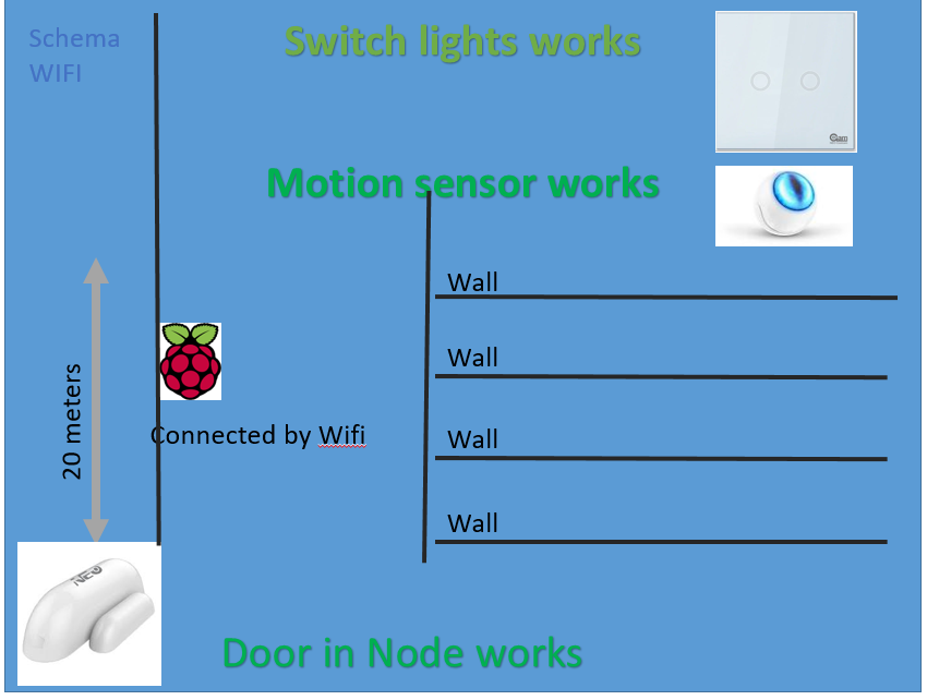

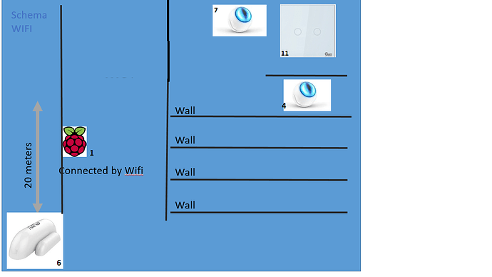

When i am moving my PI from my room to my salon, my switch lights AND motion sensor do not work simultaneously.
Schema 1: when the PI is my bed room, the door sensor is green in paper ui but in status in Node initialising: Dynamic_values and it do not work
Schema 2: When I am moving my PI to the salon,the .sendcommand to the switch takes more time.

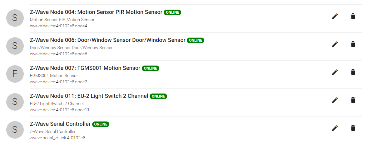

Habmin Things:
What i am missing?

Outside! Not inside a house with plenty of walls :sunglasses:
20 meters sounds about right - you would only get 100m under ideal, line of sight conditions, and probably only if antenna polarisation is aligned.
These drawings show 4 walls - what are these made of? If it’s brick/concrete, then I’d be surprised if it works at all. If it’s thin plaster walls, then it will work better. Somewhere I have some data on this, but RF propagation is not a straight forward science - especially with the low power, low efficiency antenna systems used on IoT devices.
@chris on the 4 walls, one is a support wall.
How can i overcome this issue?
do you think the upgrade to the binding 2.4 could help?
I think the only real option is to build up your mesh to give the system more opportunities at routing the data. By this, I mean specifically to add more devices “in between” the troublesome devices. The more devices in the network, the better the network will be.
Note that these need to be mains devices - your current list of devices are battery devices, so they will not be able to route frames for other devices, so will not participate in the mesh as such.
I’m not sure that it will help much with this issue - at least not without improving the mesh, In general though I would recommend upgrading as it does have a lot of improvements over the 2.3 binding. As stated above, the heal is included in the 2.4 binding which might improve things if you have devices that can be used for routing, but within your current network, this is not going to help as the battery devices will not support the mesh network.

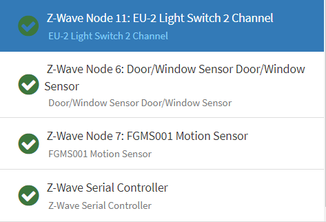

my Aeon Labs Z-Stick is detected twice. i have this record in the inbox
Except this, all my z-wave are green .
i had some issues to delete the things, this link was helpful Paper UI Can't remove Item - #5 by thehardway
New functionality recently was added that auto-detects USB devices and places them in the Inbox. You can safely ignore the inbox entry.

My z-wave switch is not performing quickly, changed from ONLINE to OFFLINE
is it a coverage issue ? poor aliexpress hardware issue ? openhab issue?
would you solve my headache :wink:?
i want to underline my fibaro motion sensor in the same room works well

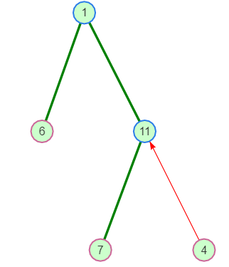

Node 11 looks like the only mains device in your network. Nodes 4, 6, and 7 are battery devices. Is this right?
How far is node 4 from node 11 and hor far from the controller?
You may benefit from more mains devices to help with routing.
Thanks for your answer
between 4 to 7 , two meters with a wall between them
That’s the switch 11 which works bad
What’s the construction of the wall?
If the switch (node 11) is having problems, then that’s likely the reason node 4 is having problems.
If it were me, I’d try adding 1 or 2 mains-powered devices to help with the routing.

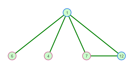

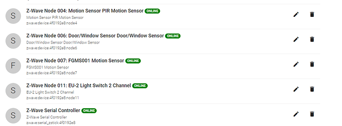

It works now !
Upgraded to the last milestone openHAB 2.4.0 Build #1451
i have removed the switch from openhab from the console and resetted the Switch.
Before
After
