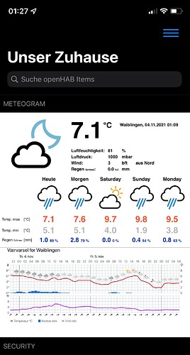

Hi together,
short update: Finally made it and brought my loved system back to the native iOS App with OH3.1.0 utilizing executeCommandLine and simple sed command to copy and afterwards edit/update an html template file. Wanted to share this here:
Thanks @rlkoshak , your wording “has been forbidden to do so” was the trigger to search in this direction :wink:

Hi @Fdewaele
for the last 2hr i wrote the how to, then drag and dropped the zip file with the required icon files and - hush - my text with everything was gone. So once again
my approach is a little hacky. I have created a html template with placeholders. I am copying this template file to a productive file using executecommandline and afterwards replacing the placeholders with item values using sed via executecommandline.
The files are lying here:
/etc/openhab/html/weather-data/images/wu_black_family/day/
/etc/openhab/html/weather-data/images/wu_black_family/night/
/etc/openhab/html/weather-data/layouts/weatherWN.css
/etc/openhab/html/weather-data/layouts/weatherWN.js
/etc/openhab/html/weather-data/OH3weatherWN_template.html
/etc/openhab/html/weather-data/OH3weatherWN.html
/etc/openhab/html/yr.html
/etc/openhab/transform/windDirection.scale
/etc/openhab/transform/windSpeed.scale
/etc/openhab/transform/openweathermap_icon.map
/etc/openhab/sitemaps/home.sitemap
/etc/openhab/rules/openweathermap.rules
/etc/openhab/items/openweathermap.items
There i had to assure, that i can work with shell commands from openHAB (i did a little back and forth with authorized_keys and ssh, but i dont no whether this was really necessary, i believe not).
In addition you would need a item called NightState as Switch (ON, OFF) to make the icon dependend on the current DayNight.
So here are the required files:
home.sitemap:
sitemap home label="Unser Zuhause" {
  // Weather widget
  Frame label="Meteogram" {
    Webview icon=none url="http://192.168.178.2:8080/static/weather-data/OH3weatherWN.html" height=6
    Webview url="http://192.168.178.2:8080/static/yr.html" icon=none height=4
openweathermap.items:
// Current weather
String								localCurrentStationMeasurement								"Letzte Messung [%s]"																							<sun_clouds>
String								localCurrentWeatherSummary										"Aktuell [%s]"																										<openweathermap_current>
DateTime							localCurrentLastMeasurement										"Letzte Messung [%1$td.%1$tm.%1$tY %1$tH:%1$tM]"									<time>													(gOpenWeatherMap_Timestamp)					{channel="openweathermap:weather-and-forecast:api:local:current#time-stamp"}	//Timestamp of last measurement
Number:Length					localCurrentRainVolume												"Regen [%.1f %unit%]"																							<rain>																															{channel="openweathermap:weather-and-forecast:api:local:current#rain"}	//Current rain volume
Number:Length					localCurrentSnowVolume												"Schnee [%.1f %unit%]"																						<snow>																															{channel="openweathermap:weather-and-forecast:api:local:current#snow"}	//Current snow volume
String								localCurrentConditionID												"Wetter ID [%s]"																									<openweathermap_current>				(gOpenWeatherMap_Icon)							{channel="openweathermap:weather-and-forecast:api:local:current#condition-id"}
Number:Temperature		localCurrentTemperature												"Temperatur [%.1f %unit%]"																				<temperature>										(gOpenWeatherMap_WeatherSummary)		{channel="openweathermap:weather-and-forecast:api:local:current#temperature"}	//Current temperature
Number:Pressure				localCurrentPressure													"Luftdruck [%.1f %unit%]"																					<pressure>																													{channel="openweathermap:weather-and-forecast:api:local:current#pressure"}	//Current barometric pressure
Number:Dimensionless	localCurrentHumidity													"Luftfeuchtigkeit [%d %unit%]"																		<humidity>																													{channel="openweathermap:weather-and-forecast:api:local:current#humidity"}	//Current atmospheric humidity
Number:Speed					localCurrentWindSpeed													"Wind [%.1f %unit%]"																							<wind>													(gOpenWeatherMap_WindSpeed)					{channel="openweathermap:weather-and-forecast:api:local:current#wind-speed"}	//Current wind speed
Number:Angle					localCurrentWindDirection											"Aus Richtung [%d %unit%]"																				<wind>													(gOpenWeatherMap_WindDirection)			{channel="openweathermap:weather-and-forecast:api:local:current#wind-direction"}	//Current wind direction
// Vorhersage fĂŒr HEUTE
Number:Length					localDailyForecastTodayRainVolume							"Regen [%.1f %unit%]"																							<rain>																															{channel="openweathermap:weather-and-forecast:api:local:forecastToday#rain"}	//Rain volume for today
Number:Length					localDailyForecastTodaySnowVolume							"Schnee [%.1f %unit%]"																						<snow>																															{channel="openweathermap:weather-and-forecast:api:local:forecastToday#snow"}	//Snow volume for today
Number:Dimensionless  localDailyForecastTodayPrecipProbability    	"Regenwahrscheinlichkeit [%.0f] %"																<rain>																															{channel="openweathermap:onecall:api:OWM1CAPI:forecastToday#precip-probability"}	//Snow volume for today
String								localDailyForecastTodayConditionID						"Wetter ID [%s]"																									<openweathermap_dailytoday>			(gOpenWeatherMap_Icon)							{channel="openweathermap:weather-and-forecast:api:local:forecastToday#condition-id"}	//Condition for today
Number:Temperature		localDailyForecastTodayMinTemperature					"Temperatur Min. [%.1f %unit%]"																		<temperature>										(gOpenWeatherMap_WeatherSummary)		{channel="openweathermap:weather-and-forecast:api:local:forecastToday#min-temperature"}	//Minimum temperature for today
Number:Temperature		localDailyForecastTodayMaxTemperature					"Temperatur Max. [%.1f %unit%]"																		<temperature>										(gOpenWeatherMap_WeatherSummary)		{channel="openweathermap:weather-and-forecast:api:local:forecastToday#max-temperature"}	//Maximum temperature for today
// Vorhersage fĂŒr MORGEN
Number:Length					localDailyForecastTomorrowRainVolume					"Regen [%.1f %unit%]"																							<rain>																															{channel="openweathermap:weather-and-forecast:api:local:forecastTomorrow#rain"}	//Rain volume for today
Number:Length					localDailyForecastTomorrowSnowVolume					"Schnee [%.1f %unit%]"																						<snow>																															{channel="openweathermap:weather-and-forecast:api:local:forecastTomorrow#snow"}	//Snow volume fo
Number:Dimensionless  localDailyForecastTomorrowPrecipProbability   "Regenwahrscheinlichkeit [%.0f] %"																<rain>																															{channel="openweathermap:onecall:api:OWM1CAPI:forecastTomorrow#precip-probability"}	//Snow volume for today
String								localDailyForecastTomorrowConditionID					"Wetter ID [%s]"																									<openweathermap_dailytomorrow>	(gOpenWeatherMap_Icon)							{channel="openweathermap:weather-and-forecast:api:local:forecastTomorrow#condition-id"}	//Condition for today
Number:Temperature		localDailyForecastTomorrowMinTemperature			"Temperatur Min. [%.1f %unit%]"																		<temperature>										(gOpenWeatherMap_WeatherSummary)		{channel="openweathermap:weather-and-forecast:api:local:forecastTomorrow#min-temperature"}	//Minimum temperature for today
Number:Temperature		localDailyForecastTomorrowMaxTemperature			"Temperatur Max. [%.1f %unit%]"																		<temperature>										(gOpenWeatherMap_WeatherSummary)		{channel="openweathermap:weather-and-forecast:api:local:forecastTomorrow#max-temperature"}	//Maximum temperature for today
// Vorhersage fĂŒr ÜBERMORGEN / in 2 Tagen
DateTime							localDailyForecastDay2Timestamp								"Vorhersage fĂŒr ÜBERMORGEN [%1$tA, %1$td.%1$tm.%1$tY]"						<time>													(gOpenWeatherMap_Timestamp)					{channel="openweathermap:weather-and-forecast:api:local:forecastDay2#time-stamp"}	//Timestamp of forecast
Number:Length					localDailyForecastDay2RainVolume							"Regen [%.1f %unit%]"																							<rain>																															{channel="openweathermap:weather-and-forecast:api:local:forecastDay2#rain"}	//Rain volume for today
Number:Length					localDailyForecastDay2SnowVolume							"Schnee [%.1f %unit%]"																						<snow>																															{channel="openweathermap:weather-and-forecast:api:local:forecastDay2#snow"}	//Snow volume fo
Number:Dimensionless  localDailyForecastDay2PrecipProbability       "Regenwahrscheinlichkeit [%.0f] %"																<rain>																															{channel="openweathermap:onecall:api:OWM1CAPI:forecastDay2#precip-probability"}	//Snow volume for today
String								localDailyForecastDay2ConditionID							"Wetter ID [%s]"																									<openweathermap_dailyday2>			(gOpenWeatherMap_Icon)							{channel="openweathermap:weather-and-forecast:api:local:forecastDay2#condition-id"}	//Condition for today
Number:Temperature		localDailyForecastDay2MinTemperature					"Temperatur Min. [%.1f %unit%]"																		<temperature>										(gOpenWeatherMap_WeatherSummary)		{channel="openweathermap:weather-and-forecast:api:local:forecastDay2#min-temperature"}	//Minimum temperature for today
Number:Temperature		localDailyForecastDay2MaxTemperature					"Temperatur Max. [%.1f %unit%]"																		<temperature>										(gOpenWeatherMap_WeatherSummary)		{channel="openweathermap:weather-and-forecast:api:local:forecastDay2#max-temperature"}	//Maximum temperature for today
// Vorhersage fĂŒr IN 3 TAGEN
DateTime							localDailyForecastDay3Timestamp								"Vorhersage fĂŒr IN 3 TAGEN [%1$tA, %1$td.%1$tm.%1$tY]"						<time>													(gOpenWeatherMap_Timestamp)					{channel="openweathermap:weather-and-forecast:api:local:forecastDay3#time-stamp"}	//Timestamp of forecast
Number:Length					localDailyForecastDay3RainVolume							"Regen [%.1f %unit%]"																							<rain>																															{channel="openweathermap:weather-and-forecast:api:local:forecastDay3#rain"}	//Rain volume for today
Number:Length					localDailyForecastDay3SnowVolume							"Schnee [%.1f %unit%]"																						<snow>																															{channel="openweathermap:weather-and-forecast:api:local:forecastDay3#snow"}	//Snow volume fo
Number:Dimensionless  localDailyForecastDay3PrecipProbability       "Regenwahrscheinlichkeit [%.0f] %"																<rain>																															{channel="openweathermap:onecall:api:OWM1CAPI:forecastDay3#precip-probability"}	//Snow volume for today
String								localDailyForecastDay3ConditionID							"Wetter ID [%s]"																									<openweathermap_dailyday3>			(gOpenWeatherMap_Icon)							{channel="openweathermap:weather-and-forecast:api:local:forecastDay3#condition-id"}	//Condition for today
Number:Temperature		localDailyForecastDay3MinTemperature					"Temperatur Min. [%.1f %unit%]"																		<temperature>										(gOpenWeatherMap_WeatherSummary)		{channel="openweathermap:weather-and-forecast:api:local:forecastDay3#min-temperature"}	//Minimum temperature for today
Number:Temperature		localDailyForecastDay3MaxTemperature					"Temperatur Max. [%.1f %unit%]"																		<temperature>										(gOpenWeatherMap_WeatherSummary)		{channel="openweathermap:weather-and-forecast:api:local:forecastDay3#max-temperature"}	//Maximum temperature for today
// Vorhersage fĂŒr IN 4 TAGEN
DateTime							localDailyForecastDay4Timestamp								"Vorhersage fĂŒr IN 4 TAGEN [%1$tA, %1$td.%1$tm.%1$tY]"						<time>													(gOpenWeatherMap_Timestamp)					{channel="openweathermap:weather-and-forecast:api:local:forecastDay4#time-stamp"}	//Timestamp of forecast
Number:Length					localDailyForecastDay4RainVolume							"Regen [%.1f %unit%]"																							<rain>																															{channel="openweathermap:weather-and-forecast:api:local:forecastDay4#rain"}	//Rain volume for today
Number:Length					localDailyForecastDay4SnowVolume							"Schnee [%.1f %unit%]"																						<snow>																															{channel="openweathermap:weather-and-forecast:api:local:forecastDay4#snow"}	//Snow volume fo
Number:Dimensionless  localDailyForecastDay4PrecipProbability       "Regenwahrscheinlichkeit [%.0f] %"																<rain>																															{channel="openweathermap:onecall:api:OWM1CAPI:forecastDay4#precip-probability"}	//Snow volume for today
String								localDailyForecastDay4ConditionID							"Wetter ID [%s]"																									<openweathermap_dailyday4>			(gOpenWeatherMap_Icon)							{channel="openweathermap:weather-and-forecast:api:local:forecastDay4#condition-id"}	//Condition for today
Number:Temperature		localDailyForecastDay4MinTemperature					"Temperatur Min. [%.1f %unit%]"																		<temperature>										(gOpenWeatherMap_WeatherSummary)		{channel="openweathermap:weather-and-forecast:api:local:forecastDay4#min-temperature"}	//Minimum temperature for today
Number:Temperature		localDailyForecastDay4MaxTemperature					"Temperatur Max. [%.1f %unit%]"																		<temperature>										(gOpenWeatherMap_WeatherSummary)		{channel="openweathermap:weather-and-forecast:api:local:forecastDay4#max-temperature"}	//Maximum temperature for today
rule "Update weatherWN HTML"
    System started or
    Item localCurrentLastMeasurement changed or
    Item execResetWeather changed to ON
    //Time cron "0 0/15 * ? * * *"
    Thread::sleep(500)
    logInfo("Update weatherWN HTML", "Running ...")
    // Copy template file
    executeCommandLine("cp", "-f", "/etc/openhab/html/weather-data/OH3weatherWN_template.html", "/etc/openhab/html/weather-data/OH3weatherWN.html")
    Thread::sleep(1000)
    var daynight = "day"
    if (NightState.state == ON) {
        daynight = "night"
    val iconcurrent = transform("MAP", "openweathermap_icon.map", localCurrentConditionID.state.toString)
    executeCommandLine("sed", "-i", "s|ICONCURRENT|"+daynight+"/"+iconcurrent+"|", "/etc/openhab/html/weather-data/OH3weatherWN.html")
    executeCommandLine("sed", "-i", "s|TEMPERATURECURRENT|"+localCurrentTemperature.state.format("%.1f")+"|", "/etc/openhab/html/weather-data/OH3weatherWN.html")
    executeCommandLine("sed", "-i", "s|DATECURRENT|"+localCurrentLastMeasurement.state.format("%1$td.%1$tm.%1$tY %1$tH:%1$tM")+"|", "/etc/openhab/html/weather-data/OH3weatherWN.html")
    executeCommandLine("sed", "-i", "s|HUMIDITYCURRENT|"+localCurrentHumidity.state.format("%.0f")+"|", "/etc/openhab/html/weather-data/OH3weatherWN.html")
    executeCommandLine("sed", "-i", "s|PRESSURCURRENT|"+localCurrentPressure.state.format("%.0f")+"|", "/etc/openhab/html/weather-data/OH3weatherWN.html")
    val windspeed = transform("SCALE", "windSpeed.scale", (localCurrentWindSpeed.state as QuantityType<Number>).floatValue.toString)
    val winddir = transform("SCALE", "windDirection.scale", (localCurrentWindDirection.state as QuantityType<Number>).floatValue.toString)
    executeCommandLine("sed", "-i", "s|WINDSPEEDCURRENT|"+windspeed+"|", "/etc/openhab/html/weather-data/OH3weatherWN.html")
    executeCommandLine("sed", "-i", "s|WINDDIRECTIONCURRENT|"+winddir+"|", "/etc/openhab/html/weather-data/OH3weatherWN.html")
    executeCommandLine("sed", "-i", "s|RAINCURRENT|"+localCurrentRainVolume.state.format("%.1f")+"|", "/etc/openhab/html/weather-data/OH3weatherWN.html")
    executeCommandLine("sed", "-i", "s|SNOWCURRENT|"+localCurrentSnowVolume.state.format("%.1f")+"|", "/etc/openhab/html/weather-data/OH3weatherWN.html")
    executeCommandLine("sed", "-i", "s|DAY+2|"+localDailyForecastDay2Timestamp.state.format("%1$tA")+"|", "/etc/openhab/html/weather-data/OH3weatherWN.html")
    executeCommandLine("sed", "-i", "s|DAY+3|"+localDailyForecastDay3Timestamp.state.format("%1$tA")+"|", "/etc/openhab/html/weather-data/OH3weatherWN.html")
    executeCommandLine("sed", "-i", "s|DAY+4|"+localDailyForecastDay4Timestamp.state.format("%1$tA")+"|", "/etc/openhab/html/weather-data/OH3weatherWN.html")
    val icon0 = transform("MAP", "openweathermap_icon.map", localDailyForecastTodayConditionID.state.toString)
    val icon1 = transform("MAP", "openweathermap_icon.map", localDailyForecastTomorrowConditionID.state.toString)
    val icon2 = transform("MAP", "openweathermap_icon.map", localDailyForecastDay2ConditionID.state.toString)
    val icon3 = transform("MAP", "openweathermap_icon.map", localDailyForecastDay3ConditionID.state.toString)
    val icon4 = transform("MAP", "openweathermap_icon.map", localDailyForecastDay4ConditionID.state.toString)
    executeCommandLine("sed", "-i", "s|ICON+0|"+icon0+"|", "/etc/openhab/html/weather-data/OH3weatherWN.html")
    executeCommandLine("sed", "-i", "s|ICON+1|"+icon1+"|", "/etc/openhab/html/weather-data/OH3weatherWN.html")
    executeCommandLine("sed", "-i", "s|ICON+2|"+icon2+"|", "/etc/openhab/html/weather-data/OH3weatherWN.html")
    executeCommandLine("sed", "-i", "s|ICON+3|"+icon3+"|", "/etc/openhab/html/weather-data/OH3weatherWN.html")
    executeCommandLine("sed", "-i", "s|ICON+4|"+icon4+"|", "/etc/openhab/html/weather-data/OH3weatherWN.html")
    executeCommandLine("sed", "-i", "s|MAXTEMPERATURE+0|"+localDailyForecastTodayMaxTemperature.state.format("%.1f")+"|", "/etc/openhab/html/weather-data/OH3weatherWN.html")
    executeCommandLine("sed", "-i", "s|MAXTEMPERATURE+1|"+localDailyForecastTomorrowMaxTemperature.state.format("%.1f")+"|", "/etc/openhab/html/weather-data/OH3weatherWN.html")
    executeCommandLine("sed", "-i", "s|MAXTEMPERATURE+2|"+localDailyForecastDay2MaxTemperature.state.format("%.1f")+"|", "/etc/openhab/html/weather-data/OH3weatherWN.html")
    executeCommandLine("sed", "-i", "s|MAXTEMPERATURE+3|"+localDailyForecastDay3MaxTemperature.state.format("%.1f")+"|", "/etc/openhab/html/weather-data/OH3weatherWN.html")
    executeCommandLine("sed", "-i", "s|MAXTEMPERATURE+4|"+localDailyForecastDay4MaxTemperature.state.format("%.1f")+"|", "/etc/openhab/html/weather-data/OH3weatherWN.html")
    executeCommandLine("sed", "-i", "s|MINTEMPERATURE+0|"+localDailyForecastTodayMinTemperature.state.format("%.1f")+"|", "/etc/openhab/html/weather-data/OH3weatherWN.html")
    executeCommandLine("sed", "-i", "s|MINTEMPERATURE+1|"+localDailyForecastTomorrowMinTemperature.state.format("%.1f")+"|", "/etc/openhab/html/weather-data/OH3weatherWN.html")
    executeCommandLine("sed", "-i", "s|MINTEMPERATURE+2|"+localDailyForecastDay2MinTemperature.state.format("%.1f")+"|", "/etc/openhab/html/weather-data/OH3weatherWN.html")
    executeCommandLine("sed", "-i", "s|MINTEMPERATURE+3|"+localDailyForecastDay3MinTemperature.state.format("%.1f")+"|", "/etc/openhab/html/weather-data/OH3weatherWN.html")
    executeCommandLine("sed", "-i", "s|MINTEMPERATURE+4|"+localDailyForecastDay4MinTemperature.state.format("%.1f")+"|", "/etc/openhab/html/weather-data/OH3weatherWN.html")
    val RainSnow0 = ( (localDailyForecastTodayRainVolume.state as QuantityType<Length>) + (localDailyForecastTodaySnowVolume.state as QuantityType<Length>))
    val RainSnow1 = ( (localDailyForecastTomorrowRainVolume.state as QuantityType<Length>) + (localDailyForecastTomorrowSnowVolume.state as QuantityType<Length>))
    val RainSnow2 = ( (localDailyForecastDay2RainVolume.state as QuantityType<Length>) + (localDailyForecastDay2SnowVolume.state as QuantityType<Length>))
    val RainSnow3 = ( (localDailyForecastDay3RainVolume.state as QuantityType<Length>) + (localDailyForecastDay3SnowVolume.state as QuantityType<Length>))
    val RainSnow4 = ( (localDailyForecastDay4RainVolume.state as QuantityType<Length>) + (localDailyForecastDay4SnowVolume.state as QuantityType<Length>))
    executeCommandLine("sed", "-i", "s|RAINSNOW+0|"+RainSnow0.format("%.1f")+"|", "/etc/openhab/html/weather-data/OH3weatherWN.html")
    executeCommandLine("sed", "-i", "s|RAINSNOW+1|"+RainSnow1.format("%.1f")+"|", "/etc/openhab/html/weather-data/OH3weatherWN.html")
    executeCommandLine("sed", "-i", "s|RAINSNOW+2|"+RainSnow2.format("%.1f")+"|", "/etc/openhab/html/weather-data/OH3weatherWN.html")
    executeCommandLine("sed", "-i", "s|RAINSNOW+3|"+RainSnow3.format("%.1f")+"|", "/etc/openhab/html/weather-data/OH3weatherWN.html")
    executeCommandLine("sed", "-i", "s|RAINSNOW+4|"+RainSnow4.format("%.1f")+"|", "/etc/openhab/html/weather-data/OH3weatherWN.html")
    executeCommandLine("sed", "-i", "s|RAINPROBABILITY+0|"+localDailyForecastTodayPrecipProbability.state.format("%.0f")+"|", "/etc/openhab/html/weather-data/OH3weatherWN.html")
    executeCommandLine("sed", "-i", "s|RAINPROBABILITY+1|"+localDailyForecastTomorrowPrecipProbability.state.format("%.0f")+"|", "/etc/openhab/html/weather-data/OH3weatherWN.html")
    executeCommandLine("sed", "-i", "s|RAINPROBABILITY+2|"+localDailyForecastDay2PrecipProbability.state.format("%.0f")+"|", "/etc/openhab/html/weather-data/OH3weatherWN.html")
    executeCommandLine("sed", "-i", "s|RAINPROBABILITY+3|"+localDailyForecastDay3PrecipProbability.state.format("%.0f")+"|", "/etc/openhab/html/weather-data/OH3weatherWN.html")
    executeCommandLine("sed", "-i", "s|RAINPROBABILITY+4|"+localDailyForecastDay4PrecipProbability.state.format("%.0f")+"|", "/etc/openhab/html/weather-data/OH3weatherWN.html")

yr.html
<html>
    <body>
      <div align="center"><iframe src="https://www.yr.no/nb/innhold/2-2815329/meteogram.svg" style="position:relative; top:-25px; height:380px; width:780px; scale:1.2" frameborder="0"></iframe>    </div>
    </body>
</html>
<!DOCTYPE html>
<html>
<head>
	<meta http-equiv="refresh" CONTENT="5"">
	<meta http-equiv="Content-type" CONTENT="text/html; charset=utf-8">
	<meta name="viewport" content="width=device-width, initial-scale=0.6, user-scalable=yes">
	<link rel="stylesheet" type="text/css" href="./layouts/weatherWN.css" />
</head>
<body id="weather-body" onload="formatIframe()">
	<table id="weather-table">
		<tr>
			<td rowspan="2"><img id="weather-icon" src="./images/wu_black_family/ICONCURRENT.png"/></td>
			<td id="weather-temp">TEMPERATURECURRENT</td>
			<td id="weather-temp-sign">°C</td>
			<td id="weather-observation">Waiblingen, DATECURRENT</td>
		</tr>
		<tr>
			<td colspan="3">
				<table id="weather-table-details">
					<tr>
						<td>Luftfeuchtigkeit:</td>
						<td>HUMIDITYCURRENT</td>
						<td>%</td>
					</tr>
					<tr>
						<td>Luftdruck:</td>
						<td>PRESSURCURRENT</td>
						<td>mbar</td>
					</tr>
					<tr>
						<td>Wind:</td>
						<td>WINDSPEEDCURRENT</td>
						<td>bft</td>
						<td>aus WINDDIRECTIONCURRENT</td>
					</tr>
					<tr>
						<td>Regen  <span style="font-size:8px">Schnee</span>:</td>
						<td>RAINCURRENT  <span style="font-size:8px">SNOWCURRENT</span> </td>
						<!--<td>Regen:</td>
						<td>${weather:precipitation.rain(%.1f)}</td>-->
						<td>mm</td>
					</tr>
				</table>
			</td>
		</tr>
	</table>
	<table id="weather-forecast-table">
		<tr>
			<td class="dates"></td>
			<td class="dates">Heute</td>
			<td class="dates">Morgen</td>
			<td class="dates">DAY+2</td>
			<td class="dates">DAY+3</td>
			<td class="dates">DAY+4</td>
		</tr>
		<tr>
			<td></td>
			<td></td>
			<td><img src="./images/wu_black_family/day/ICON+0.png"/></td>
			<td><img src="./images/wu_black_family/day/ICON+1.png"/></td>
			<td><img src="./images/wu_black_family/day/ICON+2.png"/></td>
			<td><img src="./images/wu_black_family/day/ICON+3.png"/></td>
			<td><img src="./images/wu_black_family/day/ICON+4.png"/></td>
		</tr>
		<tr>
			<td class="label">Temp. max</td>
			<td class="unit">[°C]</td>
			<td class="temp-max">MAXTEMPERATURE+0</td>
			<td class="temp-max">MAXTEMPERATURE+1</td>
			<td class="temp-max">MAXTEMPERATURE+2</td>
			<td class="temp-max">MAXTEMPERATURE+3</td>
			<td class="temp-max">MAXTEMPERATURE+4</td>
		</tr>
		<tr>
			<td class="label">Temp. min</td>
			<td class="temp-min">MINTEMPERATURE+0</td>
			<td class="temp-min">MINTEMPERATURE+1</td>
			<td class="temp-min">MINTEMPERATURE+2</td>
			<td class="temp-min">MINTEMPERATURE+3</td>
			<td class="temp-min">MINTEMPERATURE+4</td>
		</tr>
		<tr>
			<td class="label">Regen <span style="font-size:8px">Schnee</span> </td>
			<td class="unit">[mm]</td>
			<td class="rain">RAINSNOW+0 <span style="font-size:12px">RAINPROBABILITY+0 %</span></td>
			<td class="rain">RAINSNOW+1 <span style="font-size:12px">RAINPROBABILITY+1 %</span></td>
			<td class="rain">RAINSNOW+2 <span style="font-size:12px">RAINPROBABILITY+2 %</span></td>
			<td class="rain">RAINSNOW+3 <span style="font-size:12px">RAINPROBABILITY+3 %</span></td>
			<td class="rain">RAINSNOW+4 <span style="font-size:12px">RAINPROBABILITY+4 %</span></td>
		</tr>
		<!--<tr>
			<td class="label">Wind</td>
			<td class="unit">[km/h]</td>
			<td class="wind">${forecast(0):wind.speed(%.1f)} ${forecast(0):wind.direction}</td>
			<td class="wind">${forecast(1):wind.speed(%.1f)} ${forecast(1):wind.direction}</td>
			<td class="wind">${forecast(2):wind.speed(%.1f)} ${forecast(2):wind.direction}</td>
			<td class="wind">${forecast(3):wind.speed(%.1f)} ${forecast(3):wind.direction}</td>
			<td class="wind">${forecast(4):wind.speed(%.1f)} ${forecast(4):wind.direction}</td>-->
			<!--<td class="label">Wind</td>
			<td class="wind">${forecast(0):wind.speed(%.1f)}</td>
			<td class="wind">${forecast(1):wind.speed(%.1f)}</td>
			<td class="wind">${forecast(2):wind.speed(%.1f)}</td>
			<td class="wind">${forecast(3):wind.speed(%.1f)}</td>
			<td class="wind">${forecast(4):wind.speed(%.1f)}</td>-->
		</tr>
	</table>
</body>
</html>
