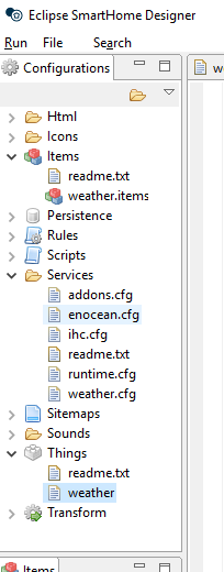

Should I create at weather thing file? (Basic knowlegde missing here).
Paper UI (Items):
OH2_pic_1
