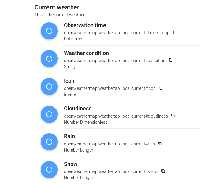

Here is what my thing looks like, everything but temperature ..
My temperature item is:
Number:Temperature CurrentTemperature "Current temperature [%.1f C]" <temperature> { channel="openweathermap:weather:api:local:current#temperature" }
.. but of course that won’t work if the channel is not there :slight_smile:

Let me chim in for a second. We had a similar discussion in the original thread. The binding will not work with OH2.3. It depends on features which are available in the latest snapshot or since OH2.4.M3 milestone build.
@bmentink After a successful upgrade you have to recreate an existing thing. New channels are not added automatically by the framework to them.
If it does not work afterwards may I ask you to provide a DEBUG log. Thanks.
