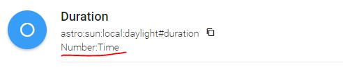

@rlkoshak do you have experience with Daylight from Astro? (guess this shows the hours a day has @ light.
Have Sunrise/set installed for years and it works, did it the same way but i only see “–” in ClassicUI.
Maybe i missed something stupid?
DateTime LocalSun_Rise_StartTime "Sunrise Miba [%1$tH:%1$tM]" <sunrise> { channel="astro:sun:local:rise#start" }
DateTime LocalSun_Set_StartTime "Sunset Miba [%1$tH:%1$tM]" <sunset> { channel="astro:sun:local:set#start" }
DateTime LocalSun_Daylight "Daylight Miba [%1$tH:%1$tM]" <daylight> { channel="astro:sun:local:daylight#duration" }
I think it’s minutes. I’ve seen it used but don’t use it myself.
If you look in PaperUI though, you will see that the daylight channel expects to be linked to a Number:Time Item, not a DateTime Item. A DateTime represents a specific instant in time, not a time duration.
You probably are seeing errors in the logs sayingsome thing like “cannot use 1401 to set DateTime Item LocalSun_Daylight”.
If you don’t want to mess with units of measurement (it’s worth learning it) it might work if you use just a Number Item.
