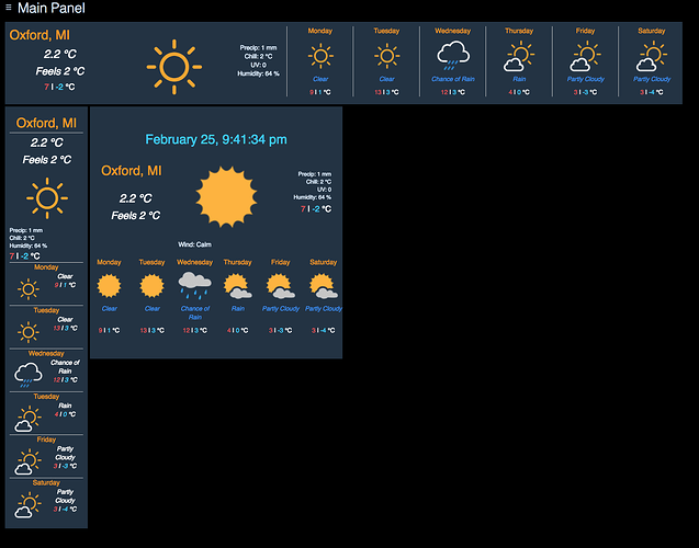

Hi
I created a new widget over the last few weeks, it can be installed in 3 possible locations as such: I haven’t tested on a tablet yet.
When creating the settings to configure some of the basic options I am having trouble creating a selection for Units. I have no problem choosing what icon sets to load, I have downloaded and renamed all the icons from the weather tutorial on this site, all the ones from weatherunderground and a few others that I have found along the way. The widget can seamlessly switch icons based on the drop down.
I have the weather configured as items for both Celcius and Fahrenheit, and I can create a setting for it, but have not successfully been able to use the setting in the code do display the correct item, or hide the rows I would like.
I have tried using the setting as a CLASS, or a VALUE, I have created scripts to lazy load in, but when the scripts read the value I want it is reading {{config.units}} not the value of the setting.
I can lazy load the javascript, I can get console log info (thats how I worked out the value being read from the page was {{config.units}} not the value of it. It seems the script is running before HabPanel updates it with the proper values.
Any suggestions on how I can read the value after it has been updated so I don’t get the tag.

I also did update the widget so you can download one and just change a config option and it switches to the different layout, I will have to delete the old ones. I would love to add a config option and use the config.layout setting to determine which layout gets displayed, but I cannot get that working, seems Angular processes everything then inserts the setting into the page then the page doesn’t update with the layout expected.
Let me know of anything else that seems a bit odd or if you modify it I can add the changes. I will also make an update soon so Fahrenheit is an option in the one widget.
