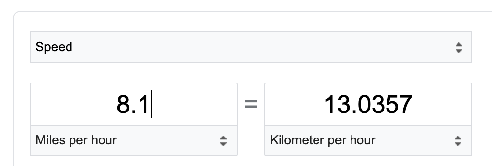

The values from the API do not match with the entries in the DB:
2021-08-06 09:47:15.860 [DEBUG] [er.WeatherCompanyObservationsHandler] - Handler: Parsing PWS observations response: {“observations”:[
{“stationID”:“IHAMBU337”,“obsTimeUtc”:“2021-08-06T07:47:13Z”,“obsTimeLocal”:“2021-08-06 09:47:13”,“neighborhood”:“Moorfleet”,“software
Type”:“EasyWeatherV1.5.9”,“country”:“DE”,“solarRadiation”:101.9,“lon”:10.086,“realtimeFrequency”:null,“epoch”:1628236033,“lat”:53.5,“u
v”:1.0,“winddir”:143,“humidity”:79.0,“qcStatus”:1,“imperial”:{“temp”:65.8,“heatIndex”:65.8,“dewpt”:59.2,“windChill”:65.8,“windSpeed”:6
.9,“windGust”:8.1,“pressure”:29.81,“precipRate”:0.00,“precipTotal”:0.00,“elev”:0.0}}]}
2021-08-06 09:49:16.105 [DEBUG] [er.WeatherCompanyObservationsHandler] - Handler: Parsing PWS observations response: {“observations”:[
{“stationID”:“IHAMBU337”,“obsTimeUtc”:“2021-08-06T07:49:05Z”,“obsTimeLocal”:“2021-08-06 09:49:05”,“neighborhood”:“Moorfleet”,“software
Type”:“EasyWeatherV1.5.9”,“country”:“DE”,“solarRadiation”:517.0,“lon”:10.086,“realtimeFrequency”:null,“epoch”:1628236145,“lat”:53.5,“u
v”:5.0,“winddir”:155,“humidity”:79.0,“qcStatus”:1,“imperial”:{“temp”:65.5,“heatIndex”:65.5,“dewpt”:58.8,“windChill”:65.5,“windSpeed”:7
.4,“windGust”:8.1,“pressure”:29.81,“precipRate”:0.00,“precipTotal”:0.00,“elev”:0.0}}]}
2021-08-06 09:51:16.373 [DEBUG] [er.WeatherCompanyObservationsHandler] - Handler: Parsing PWS observations response: {“observations”:[
{“stationID”:“IHAMBU337”,“obsTimeUtc”:“2021-08-06T07:51:13Z”,“obsTimeLocal”:“2021-08-06 09:51:13”,“neighborhood”:“Moorfleet”,“software
Type”:“EasyWeatherV1.5.9”,“country”:“DE”,“solarRadiation”:515.8,“lon”:10.086,“realtimeFrequency”:null,“epoch”:1628236273,“lat”:53.5,“u
v”:5.0,“winddir”:137,“humidity”:80.0,“qcStatus”:1,“imperial”:{“temp”:65.1,“heatIndex”:65.1,“dewpt”:58.8,“windChill”:65.1,“windSpeed”:4
.9,“windGust”:6.9,“pressure”:29.81,“precipRate”:0.00,“precipTotal”:0.00,“elev”:0.0}}]}
2021-08-06 09:53:16.631 [DEBUG] [er.WeatherCompanyObservationsHandler] - Handler: Parsing PWS observations response: {“observations”:[
{“stationID”:“IHAMBU337”,“obsTimeUtc”:“2021-08-06T07:53:05Z”,“obsTimeLocal”:“2021-08-06 09:53:05”,“neighborhood”:“Moorfleet”,“software
Type”:“EasyWeatherV1.5.9”,“country”:“DE”,“solarRadiation”:681.9,“lon”:10.086,“realtimeFrequency”:null,“epoch”:1628236385,“lat”:53.5,“u
v”:5.0,“winddir”:119,“humidity”:81.0,“qcStatus”:1,“imperial”:{“temp”:65.5,“heatIndex”:65.5,“dewpt”:59.5,“windChill”:65.5,“windSpeed”:6
.7,“windGust”:8.1,“pressure”:29.81,“precipRate”:0.00,“precipTotal”:0.00,“elev”:0.0}}]}
2021-08-06 09:55:16.910 [DEBUG] [er.WeatherCompanyObservationsHandler] - Handler: Parsing PWS observations response: {“observations”:[
{“stationID”:“IHAMBU337”,“obsTimeUtc”:“2021-08-06T07:55:13Z”,“obsTimeLocal”:“2021-08-06 09:55:13”,“neighborhood”:“Moorfleet”,“software
Type”:“EasyWeatherV1.5.9”,“country”:“DE”,“solarRadiation”:550.9,“lon”:10.086,“realtimeFrequency”:null,“epoch”:1628236513,“lat”:53.5,“u
v”:5.0,“winddir”:117,“humidity”:79.0,“qcStatus”:1,“imperial”:{“temp”:65.7,“heatIndex”:65.7,“dewpt”:59.0,“windChill”:65.7,“windSpeed”:5
.1,“windGust”:6.9,“pressure”:29.81,“precipRate”:0.00,“precipTotal”:0.00,“elev”:0.0}}]}
Here the corresponding DB entries:
2021-08-06T07:45:15.666Z PWSWindGust 9.3341952
2021-08-06T07:47:15.908Z PWSWindGust 13.0356864
2021-08-06T07:51:16.415Z PWSWindGust 11.1044736
2021-08-06T07:53:16.679Z PWSWindGust 13.0356864
2021-08-06T07:55:16.949Z PWSWindGust 11.1044736
Here again the repeating identical values…

The values in the database for wind speed do also not match the answer from the API
Assuming your region in openHAB uses metric units of measure…
API returns values in imperial units (miles per hour):
“windGust”:8.1
Which will be converted to metric by openHAB if your region uses metric units of measure. 8.1 mph converted to kilometers per hour:
Value in your DB
