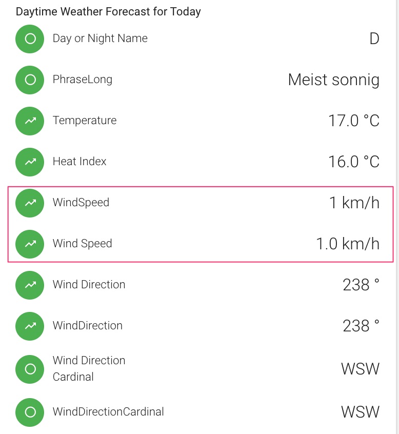

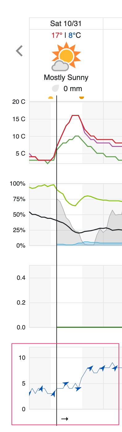

Hi Mark,
I installed the weather company binding. In the thing Weather Company Forecast all Items
Wind Speed show an incorrect value (today 1.0 km/h).
The correct value according to the website is higher (around 4.0 km/h today).
Do you have a solution?
Many thanks,
Gisela
You’ve not provided much information to help me understand the issue, let alone find the solution. The binding displays the information it receives from the Weather Company API. I have no idea what web site you’re referring to.
In the Paper UI the value for the item “wind speed” shows 1 km/h:
Paper_UI
But the correct value i my Weather Company API is more than 1 km/h:
API
Why is the value in the item “wind speed” wrong? All other items show the correct values from the API.
I’m not sure why you keep saying it’s wrong. If you put the binding in debug mode, you’ll be able to see what’s being returned by the Weather Company API. If the binding is showing something different than that, then please post the debug log, the item definition, and the value of the item from the karaf console or event log. You’ll want to look at the Wind Speed values from the Day0 (today) day and night dayparts.
Note that the value returned from the WC API might be in Imperial units, so you may need to convert the units.
Assuming they match, I have a couple of other thoughts:
  • It looks like you’re showing a screen snip from the Weather Underground web site. I’m not certain that the API and the Weather Underground UI are guaranteed to match.
  • Also, you appear to be looking at the Weather Underground hourly forecast, versus the Weather Company API, which is a twice a day forecast. I can’t imagine how those could match other than by pure coincidence.
  • Lastly, I have no idea what IBM may be doing behind the scenes with these different assets they acquired (Weather Underground, The Weather Company, and potentially others). What I do know is that things took a turn for the worse with Weather Underground following the IBM acquisition. :roll_eyes:
Configuration of the WindSpeed Items:
Number:Speed WCF_Day0_Day_WindSpeed “WindSpeed [%.0f %unit%]” { channel=“weathercompany:weather-forecast:xxx:forecastDay0Day#windSpeed” }
Number:Speed WCF_Day0_Night_WindSpeed “WindSpeed [%.0f %unit%]” { channel=“weathercompany:weather-forecast:xxx:forecastDay0Night#windSpeed” }

2020-10-31 19:19:12.707 [thome.event.ItemStateEvent] - WCF_Day0_Night_WindSpeed updated to 2.0 km/h
2020-10-31 19:24:14.607 [thome.event.ItemStateEvent] - WeatherCompanyForecast_ForecastDay1Day_WindSpeed updated to 3.0 km/h
2020-10-31 19:24:14.707 [thome.event.ItemStateEvent] - WeatherCompanyForecast_ForecastDay1Night_WindSpeed updated to 3.0 km/h
2020-10-31 19:24:14.833 [thome.event.ItemStateEvent] - WeatherCompanyForecast_ForecastDay2Day_WindSpeed updated to 2.0 km/h
2020-10-31 19:24:14.965 [thome.event.ItemStateEvent] - WeatherCompanyForecast_ForecastDay2Night_WindSpeed updated to 2.0 km/h
2020-10-31 19:24:15.060 [thome.event.ItemStateEvent] - WeatherCompanyForecast_ForecastDay3Day_WindSpeed updated to 2.0 km/h
2020-10-31 19:24:15.163 [thome.event.ItemStateEvent] - WeatherCompanyForecast_ForecastDay3Night_WindSpeed updated to 2.0 km/h
2020-10-31 19:24:15.269 [thome.event.ItemStateEvent] - WeatherCompanyForecast_ForecastDay4Day_WindSpeed updated to 3.0 km/h
2020-10-31 19:24:15.368 [thome.event.ItemStateEvent] - WeatherCompanyForecast_ForecastDay4Night_WindSpeed updated to 3.0 km/h

Please don‘t use screenshots but post your config and logs using code fences.
Thanks for posting the detail. I think I see what’s wrong.
The speed values returned from the API are in meters per second. However, the binding is updating the state using the returned value, but with the units kilometers per hour. I think that explains why the API response is 6 and your item value is 2.
Can you change your item definition from [%.0f %unit%] to [%.3f %unit%]? I expect a wind speed of 6 would result in the item value of 1.667. If so, that that would confirm it.
So, whatever wind speed value is being returned by the API, the item would be that value divided by 3.6.
Now the item value is: 2.000 km/h instead of 5 km/h
Log: 2020-11-01 21:15:12.634 [thome.event.ItemStateEvent] - WCF_Day0_Night_WindSpeed updated to 2.000 km/h
