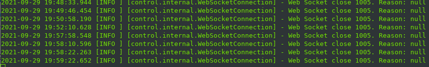

I have the 2021-09-29 21:02:43.856 [INFO ] [control.internal.WebSocketConnection] - Web Socket close 1005. Reason: null
messages as well since today. My lastVoiceCommand channel of the echo devices is not updating any more. TTS is working on echo devices

Hi all,
Same problem here (France, last stable OH) for a dozen of hours.
At this time, still have “Web Socket close 1005. Reason: null” every 1-2 min, and so no “lastVoiceCommand” update.
For those who have the problem resolved, did you restart the bundle ? Or openhab ?
Mine was working fine yesterday but now within the last hour I’m getting the web socket error. I have restarted openHAB a bunch of times, cleared the cache, logged out and back into my Amazon account, removed and reinstalled the binding but nothing seems to fix it. I’m on OH 3.1 in the US.
It seems that Amazon fixed it (their own Alexa in Webbrowser had the same problem), but apparently they don‘t roll it out for everybody at the same time.
