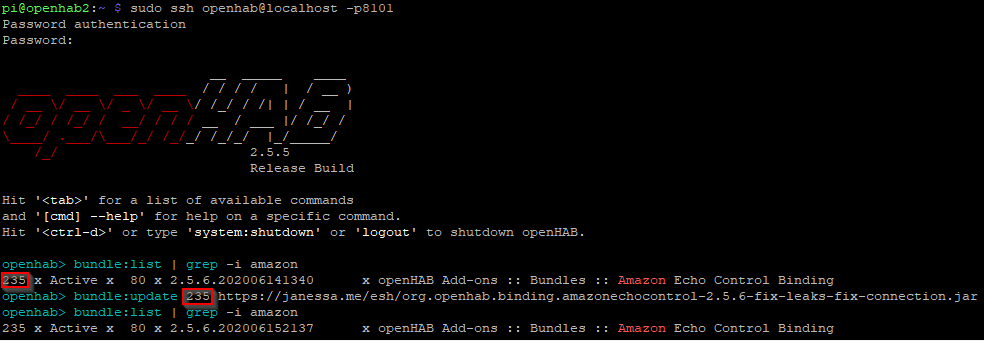

Thanks guys. That did the trick. Echo control is working and my logs aren’t exploding.
Quick overview / dumbed down version on how to resolve… alternately use: openhab-cli console rather than ssh’ing out of habit like I do :slight_smile: (password: habopen) Find bundle number for amazon binding, update it, list it again to confirm version updates ok, logout, restart OH (or reboot)

But I have a little problem, when I trie to get the ID of my binding over bundle:list | grep -i amazon I dont get anything…the amazon binding is not available in the list…but the binding is still running… what could be the problem here? thx a lot
Important!!! Case Sensitive!!! Look for grep Amazon
