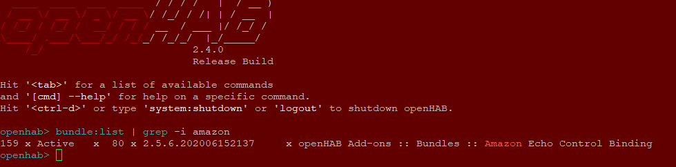

If its any help, the following worked for me. It sorted out the mem leak and log errors. Bundle listing shows 2.5.6.202006152137

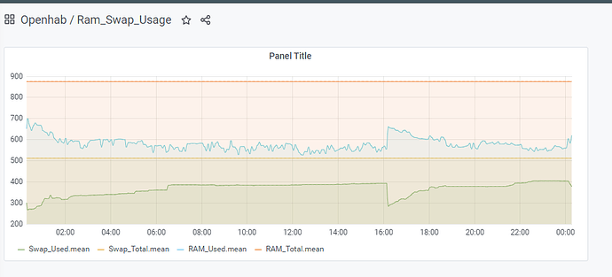

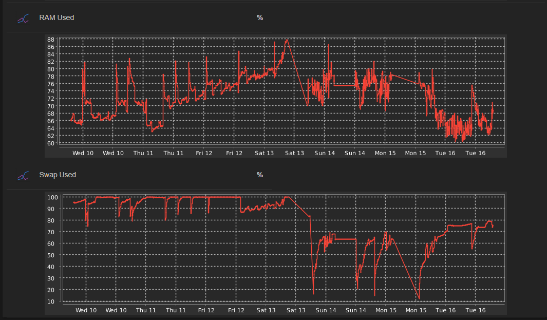

no error for last one hour . Now log looks good . Also Ram usage is stabilized
Usage for last 7 days : my system is using swap space 512 with RPI3b+ and 8-10 IOT stack docker container

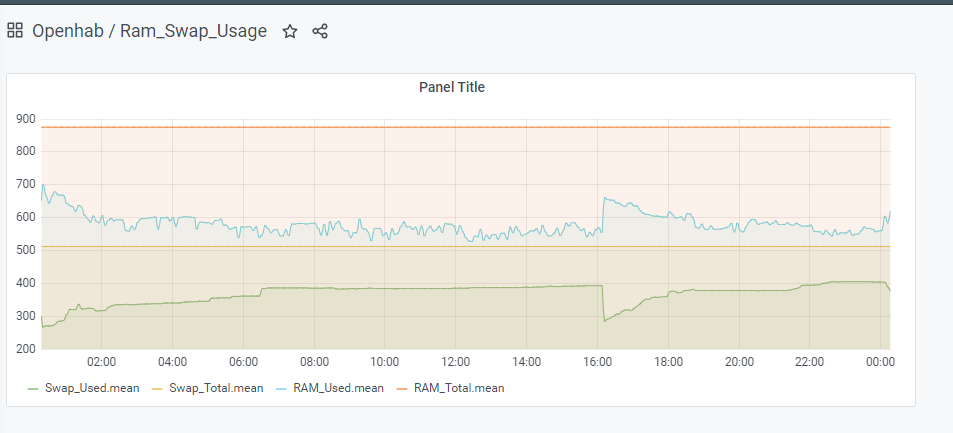

Last 24 Hrs

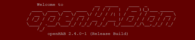

Hi ThomasOH,
I have version 2.4.0-1
I have updated the echo control bundle to the version shown below ( using the link I posted earlier )
