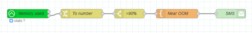

Just as an extra, my system didn’t crash from the memory leak because I caught it in time. I have the system information binding monitoring a few basic vital signs - including free memory - and some rules that push alerts to my phone via the OpenHAB Cloud if anything’s wrong. This is fairly easy and well worth doing.
