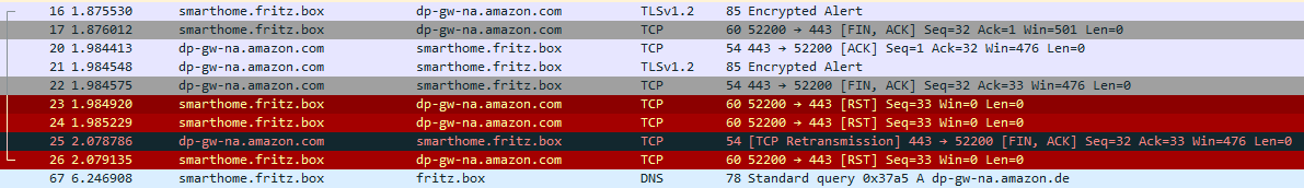

I don’t have time yet to help I would but can’t. Somebody out there records network traffic and check via wireshark what’s happening?
I did several TTS runs
Echo_Living_Room_TTS.sendCommand( '<speak><amazon:effect name="whispered">Lass mich hier raus</amazon:effect></speak>')
and ran tcpdump on openhab host in parallel for about 10 - 15 minutes
tcpdump | grep dp-gw
I did not see any hostname containing the string dp-gw while grepping for amazon returned several server names in eu-west.

with that I would conclude
=> it’s independent of OH 2.4, 2.5.X
=> independent of the amazoncontrol binding version ( apart of the OOM problem )

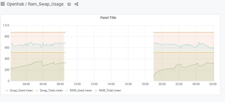

Ram Swap usage for last 7 days (All time in IST)

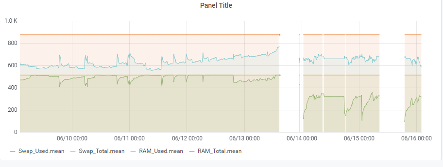

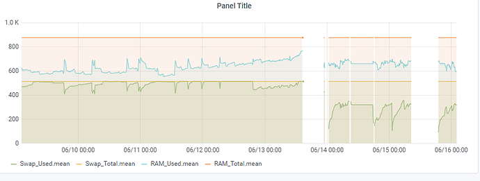

Ram Swap Usage for last 24 hr

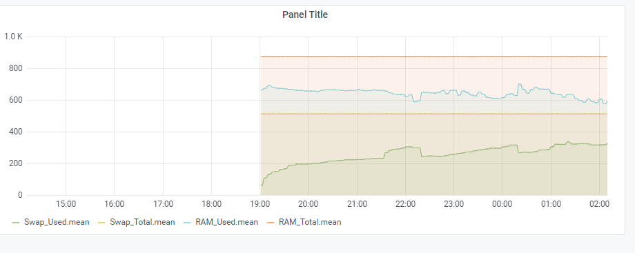

Ram Swap Usage Post jar fix
In the meantime I also updated to 2.5.6-SNAPSHOT fix, having a bit of a problem now.
