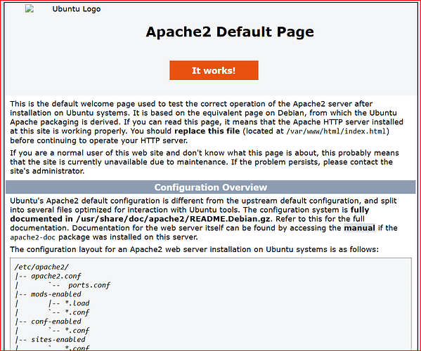

I just updated my Pi-hole to v6, and now http://192.168.1.9:8080/ doesn’t show anything. No error or nothing, just a blank screen. I tried http://192.168.1.9:8080/ in an incognito window, and that gave this result:
I assume the Pi-hole update somehow “stole” port 8080. Some looking around here on the forum confirmed this:
