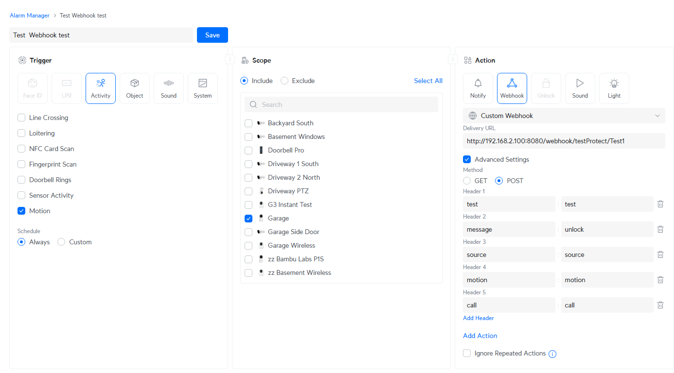

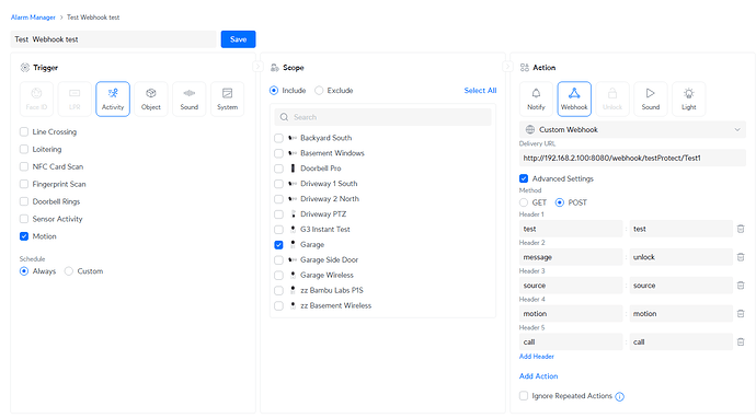

Just wondering if anyone has any idea how to get this to work with the new Unifi Protect Alarm manager. It has a webhooks option. Im not very familiar with how webhooks work or where to begin.
I created a Channel named Test1
not sure how to edit the above emaple script to get it to do anything .
if (req.parameters.action[0] == "call") {
  return "CALLING";
when i go to “http://192.168.2.100:8080/webhook/testProtect/Test1”
the LastCall channel does update. I just am unsure how to script/ what headers i need to add to make this work some how.
This is from UniFi’s Site about webhooks.
Not sure if this helps any
Advanced Settings
By default, the webhook will create an HTTP GET request each time an alarm is triggered.
For advanced cases, use the Advanced Settings:
HTTP GET allows custom headers for security tokens or other additional information.
HTTP POST delivers additional information about the alarm to your service.
Here is an example of the HTTP POST structure:
  "alarm": {
    "name": "test post",
    "sources": [],
    "conditions": [
        "condition": {
          "type": "is",
          "source": "motion"
    "triggers": [
        "key": "motion",
        "device": "74ACB99F4E24"
  "timestamp": 1722526793954
Thanks for any help.
Your device supports http/post. You do not need the webhook binding.
Create an http request:
url = ‘http://61:8080/rest/items/testItem’
contentType = “text/plain”
content = “ON”
headers:
‘Accept’: ‘/’
‘Authorization’: ‘Bearer oh.rules.DhBqiiRJiotlpI2…….’
You can create an authorization token in MainUI. Click on your name in the lower left corner.
I’ve just configured a Custom Webhook on UniFi to
http://openhabip:8080/webhook/ef07c36f7b/scan
Where “scan” is a trigger channel I’ve added to the thing with expression:
return "ON";
The thing is configured with Response expression:
resp.status=200
Then I’ve created a rule with condition:
When channel webhook:Webhook:ef07c36f7b:scan was triggered

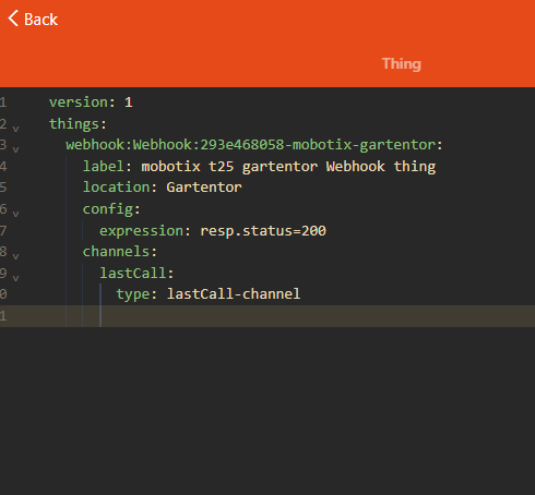

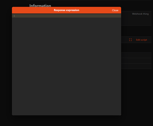

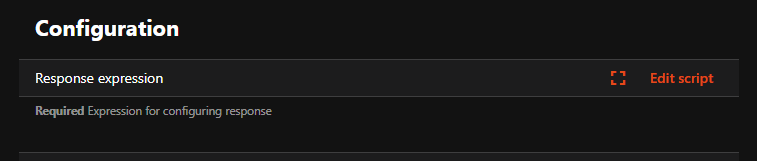

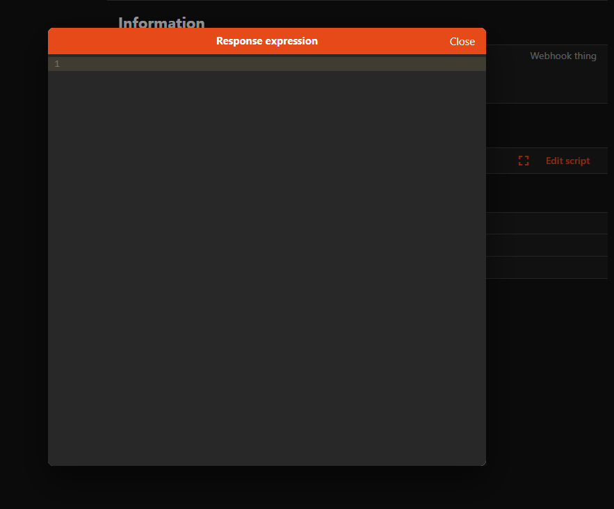

This is also for my mobotix doorcam.. during initial configuration within MainUI on OH 5.2.1, Addon installed through the UI, i see a Configuration option for “Response expression”.
Upon clicking either of the “buttons” to add an expression, the loaded “modal-window” is always empty. Whatever i type into the window is not persisted, its gone when the window is reopened.
I had to add the option in “code” block, there named “expression” for the thing to come online initially.
