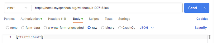

I had same spare time this morning and tested it, for me req.body.json works. I used Postman to POST a request with content type “application/json” and the body content ended up both in req.body.json and req.body.text in the JEXL.
Here is my Postman request:
The cURL command generated by Postman looks like this:
curl --location 'https://home.myopenhab.org/webhook/d1097152a4' \
--header 'Content-Type: application/json' \
--header 'Authorization: ••••••' \
--header 'Cookie: CloudServer=10.11.0.33%3A3001; X-OPENHAB-AUTH-HEADER=true' \
--data '{"test":"test"}'
The JEXL I posted in my previous post produces this output that can be processed in the triggered JavaScript rule:
{"body":{"json":{"test":"test"},"text":"{\"test\":\"test\"}"},"method":"POST","parameters":{}}

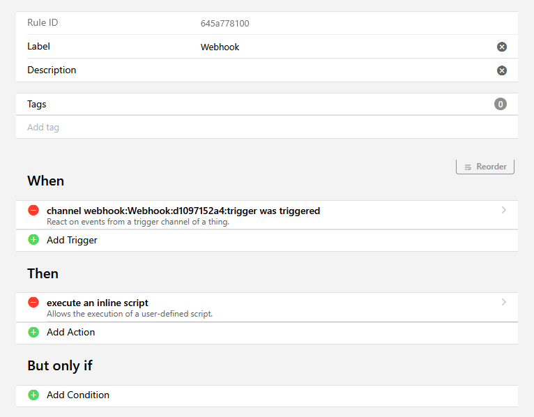

So maybe the JSON object from req.body.json is assigned to the item and then is converted on display? Do you actually need an item? You can also trigger the rule directly from the thing channel:
