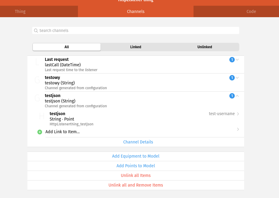

Extracting posted JSON
Following call
curl -H "Content-Type: application/json" -X POST -d '{"username":"test-username"}' http://localhost:8080/httplistener/af71afd830/
With configured thing:
  "channels": [
      "key":"testowy",
      "kind": "STATE",
      "state": "req.parameters.ekologia[0]"
     "key": "testjson",
     "kind": "STATE",
     "state": "req.body.json.username"
And result:
That’s all. :slight_smile: Any suggestions are welcomed. I do not call it early alpha or something - I wouldn’t recommend to use it on production (though I have deployed in on my openhab). However maybe some of you would be interested and have some hints how evolve it to a useful binding.

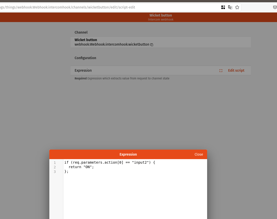

For accessing body as JSON you may try:
req.body.json.channels[1].state //.. etc
Example conditional channel configuration:
I may prepare you more direct and comprehensive example if you would paste complete request from the weather station.
