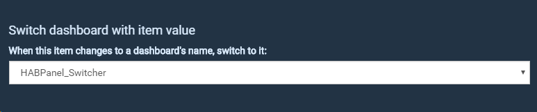

HABPanel_Switcher.postUpdate("YourCamView") where “YourCamView” is the name of the dashboard with the cam picture or stream on it.
Every time the cam detects motion the corresponding mjpeg is shown on my tablet.
Thanks I will try it on Habpanel. Yes switching via Habpanel is possible using this item. Don’t forget to define the item in Habpanel config as: Switch dashboard with item value
