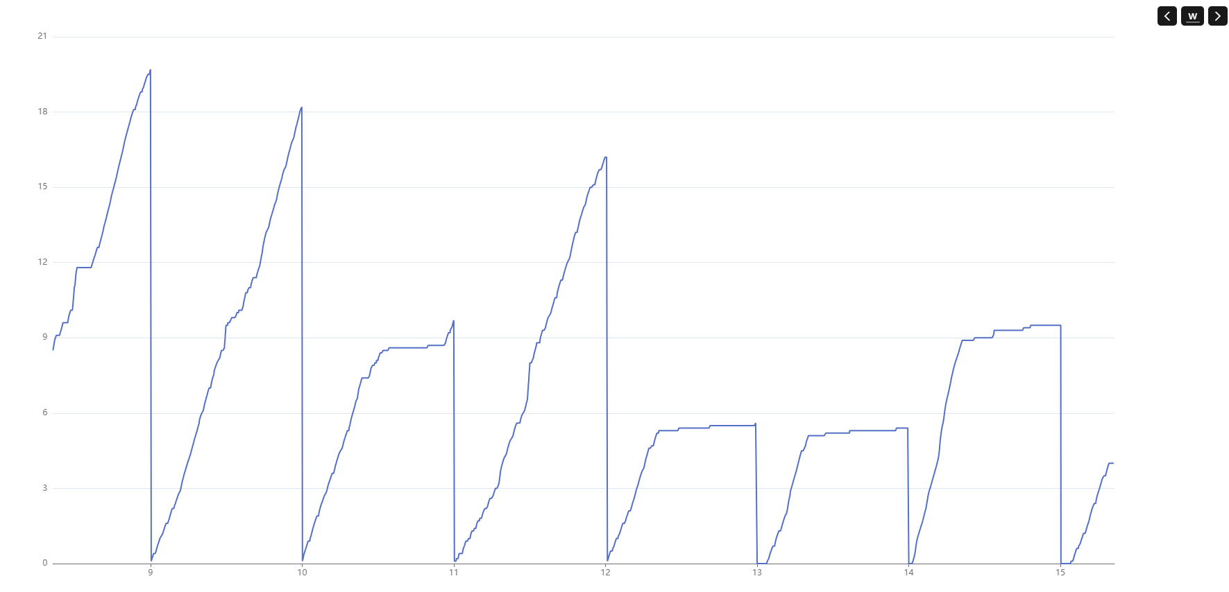

I have a energy measurement which increase every day and in the midnight goes to 0
