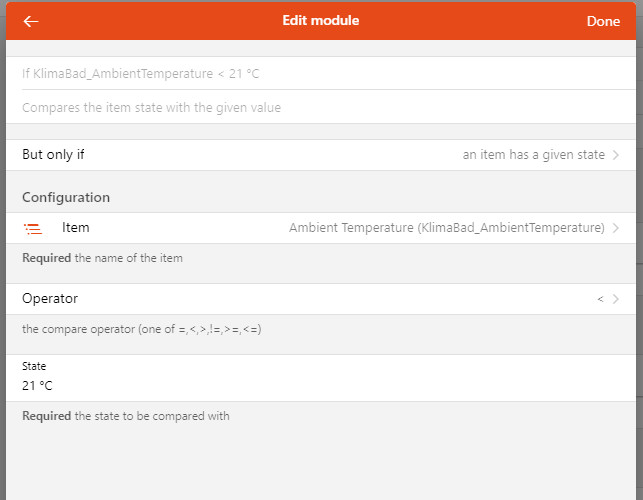

You have a rule with a condition that checks the item. The item is Number:Temperature, therefore its state is QuantityType. The rule is probably executed every minute and the condition for that rule compares the item-state to a plain number. Add a unit to the condition and the warning goes away.
