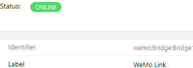

Under Things i See the Wemo Link with the ID name and status green “ONLINE” see screen shot

Bridge under thinks
