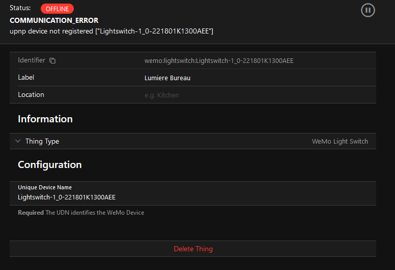

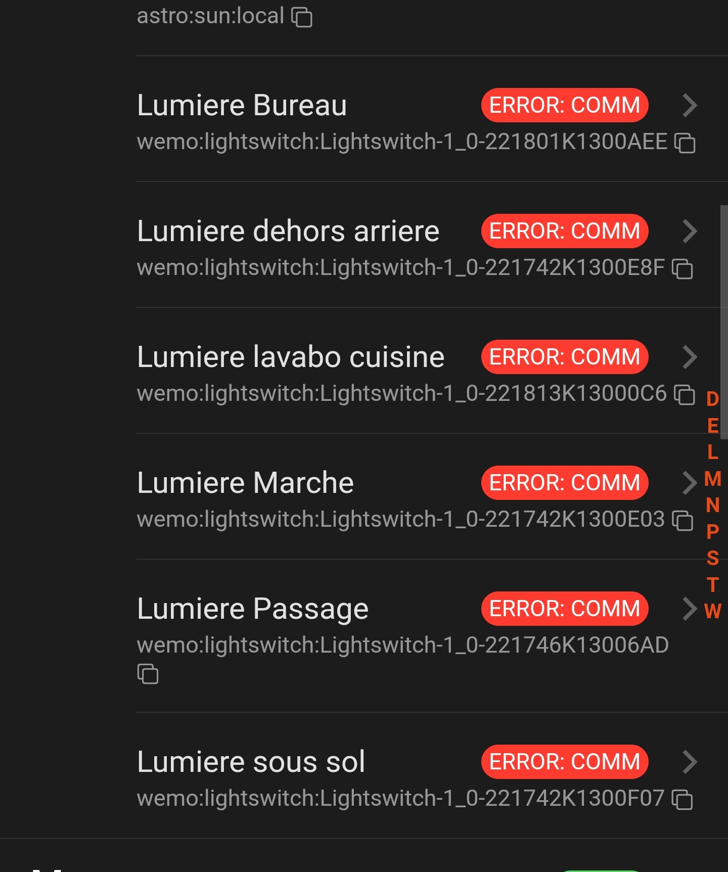

unfortunalty, error come back
COMMUNICATION_ERROR
upnp device not registered [“Lightswitch-1_0-221801K1300AEE”]
After toying with the openhab switch on/off, it has gone back online after maybe 5 minutes, but I don’t know for how much long it was offline with another one. Might be a coincidence, but 2 wasn’t working from at least 12:10 to 12:!5

OK, I’ll redownload the 3.3.0 snapshot. Note that between the last one before still gave me error, but instead of having them offline in red, they are in green showing
CONFIGURATION_PENDING
config-status.pending.device-not-registered [“Lightswitch-1_0-221801K1300AEE”]
But still not working. I’ll update with the newer version you just posted
