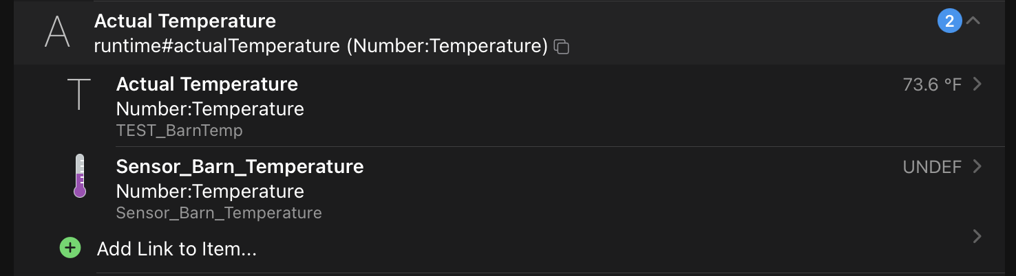

I have about 30 items showing a status of UNDEF. I can look at one in the logs after a reboot and see it changed from NULL to UNDEF.
2023-04-11 21:06:37.335 [INFO ] [openhab.event.ItemStateChangedEvent ] - Item 'Sensor_OutdoorDriveway_Temperature' changed from NULL to UNDEF
However, if I go to the thing, and create a new test item and link it to the same channel as the UNDEF item above, it happily gets a value:
2023-04-11 21:06:05.604 [INFO ] [openhab.event.ItemStateChangedEvent ] - Item 'TEST_temperature' changed from NULL to 67.37 °F
2023-04-11 21:07:02.789 [INFO ] [openhab.event.ItemStateChangedEvent ] - Item 'TEST_temperature' changed from 67.37 °F to 66.866 °F
2023-04-11 21:12:02.236 [INFO ] [openhab.event.ItemStateChangedEvent ] - Item 'TEST_temperature' changed from 66.866 °F to 66.614 °F
It may have started in mid-march with 3.4.2? This is a very busy time for me and we’ve had construction going on so I haven’t paid as much attention as I’d have liked… and sadly don’t have as much time to troubleshoot as I’d like, but the wife just complained about a rule not running and the device showed UNDEF…
What binding? Some bindings will update Items to UNDEF when they lose connectivity to the device (or the bridge). That’s usually frowned upon so that’s not common behavior.
More usually an Item changes to UNDEF because you have a rule that changes it to that or there is an Expire configured on the Item to change it to that when the Item doesn’t update or change for too long.
Rich - thank you kindly for your reply (and all of your support of these forums!).
The thing is, it is a mix of bindings - unifi, icalendar, systeminfo, hue, ecobee, and others… and the things are online and reporting results in other channels.
I don’t use the expire binding. I have a script that uses the API to populate a database with item info for easy seaching/sorting/etc.
But the weird behavior is that if I link a second item to the same channel, it gets a valid value while the previously-created item remains UNDEF. See above, and below (just created this one).
A couple more tests:
I can use info from the database to delete and recreate the item and it works as well.
However:
If I remove the link, but not the item, and then re-link it to the same channel I get UNDEF.
