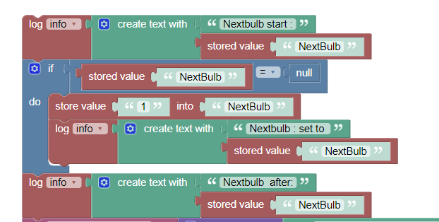

Hi @rlkoshak ,
I’ve played arround a but with that storedvalue.
But I already fail at the start.
In this snipplet I wanted to check if it’s already set and if not then set it. (Inital Start state after restart).
logger.info(('Nextbulb start :' + String(this.storedValues['NextBulb'])));
if ((this.storedValues['NextBulb']) == null) {
  this.storedValues['NextBulb'] = '1';
  logger.info(('Nextbulb : set to ' + String(this.storedValues['NextBulb'])));
logger.info(('Nextbulb  after:' + String(this.storedValues['NextBulb'])));
But the output is always:
(Looks like it’s always undefined).
Did I missunderstood this feature?
2021-12-22 14:28:22.685 [INFO ] [org.openhab.rule.FadeColors         ] - Nextbulb start :undefined
2021-12-22 14:28:22.761 [INFO ] [org.openhab.rule.FadeColors         ] - Nextbulb : set to 1
2021-12-22 14:28:22.765 [INFO ] [org.openhab.rule.FadeColors         ] - Nextbulb  after:1
The “if stored value “NextBulb” = null” . To start, the value will be undefined because it doesn’t exist. Nothing in this rule actually sets it to null so the if statement should never run. But the logs are showing that it did run so I don’t know what’s going on.

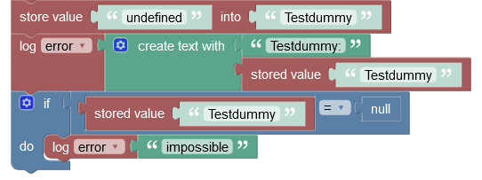

Accessing an uninitialized stored value should throw an exception:
21:16:10.625 [ERROR] [.internal.handler.ScriptActionHandler] - Script execution of rule with UID '4b9f2cd9ba' failed: TypeError: Cannot read property "Testdummy " from undefined in <eval> at line number 20
log output:
21:28:12.162 [ERROR] [org.openhab.rule.4b9f2cd9ba          ] - Testdummy:undefined
"undefined" isn’t the same things as undefined.
That error implies that this.storedValues doesn’t exist, which shouldn’t be the case because as soon as you us a store value it should create that dict. When you query for a key that doesn’t exist in a dict, you get back undefined, not an error.
I would want to see the JS code backing that Blockly to understand more about what’s happening.

It depends:
Create a new rule:
logger.error(('Test124: ' + String(this.storedValues['Test124'])));
Result:
22:26:35.396 [ERROR] [.internal.handler.ScriptActionHandler] - Script execution of rule with UID '8fc7061bec' failed: TypeError: Cannot read property "Test124" from undefined in <eval> at line number 4
openHABian / openHAB 3.2.0-SNAPSHOT - Build #2630
Add a ‘store value’
if (typeof this.storedValues === 'undefined') {
  this.storedValues = [];
this.storedValues['B'] = 'A';
Result:
22:40:11.542 [ERROR] [org.openhab.rule.8fc7061bec ] - Test124: undefined
Well yes, you never saved the value.
store value will put the value into this.storedValues. stored values will pull the value from this.storedValues. You can’t pull a value before you’ve stored it.
And the code that creates this.storedValues in the first place doesn’t get added to the rule until you have a store value block. It doesn’t make sense to create it if you are not storing anything in it. And it doesn’t make sense to query values from it if you never store any values in it in the first place.
