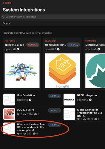

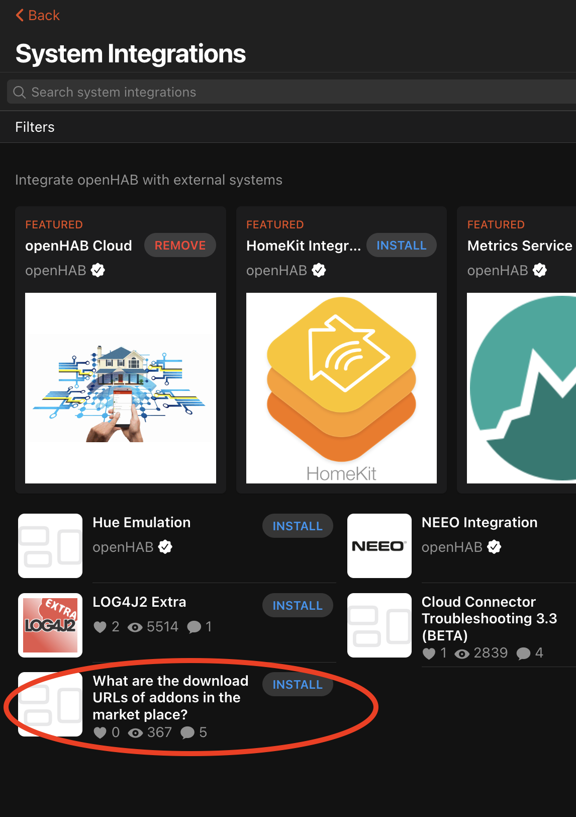

@rlkoshak this somehow showed up in my add-ons store when I enabled "show unpublished add-ons :smiley:
Moved….
MainUI checks for valid Marketplace posts when you open the addon-store menu
