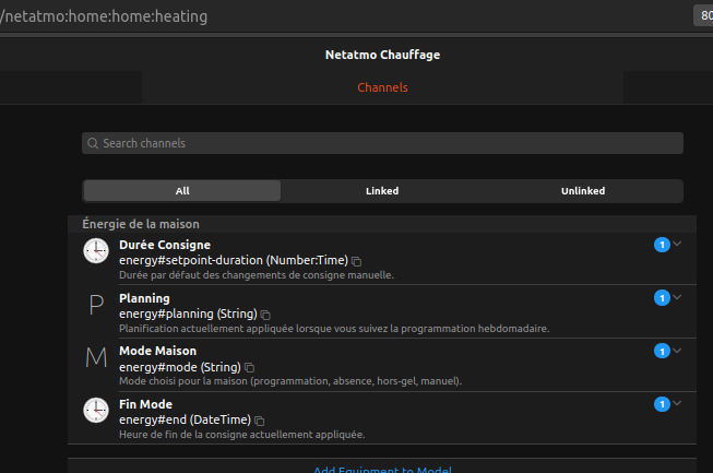

Apart from the Room thing, there used to be a Home thing with 4 channels. It was mentioned in the documentation before 3.4.0 went live but it didn’t mention the possible values of the mode channel.
If a thing and its channels is missing in the documentation, I assume @glhopital will confirm and add it.
According to the UI, there are 4 possible modes :
This is in sync with capabilities offered by Netatmo :
The only “tricky” one is that you can’t define “MANUAL”, that is the result of setting a setpoint on your thermostat and results in an INFO logged :
@Lolodomo : SetpointMode enum holds certain value that can be applied to Room (MAX and HOME) and not to the whole house :
The four channels of the Home are available to me :
@glhopital are you on 3.4.0?
If you are, that’s a relief. However, they were not included in the official documentation of 3.4.0 and were removed from 3.3.0
Yes, I’m on 3.4 but no major modification happened on the Netatmo Binding since 3.3 apart some bug fixing.
Can you please update the doc if these channels arei mssing?
